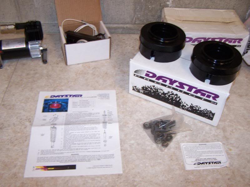

the gear.

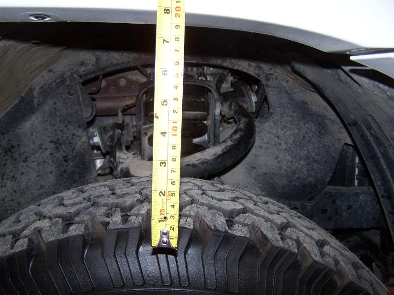

pre shot 4 3/4 inch fender gap.

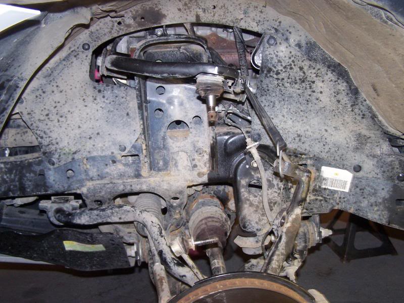

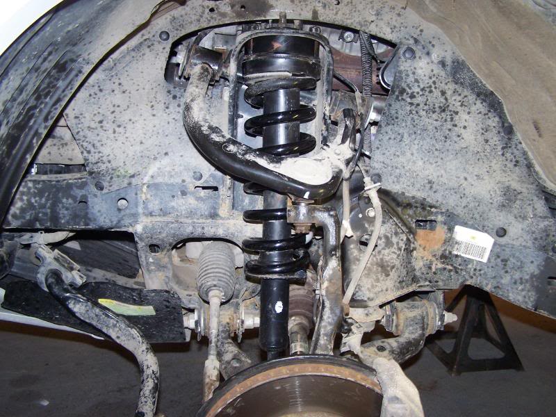

-the sway bar end links and remove the upper ball joint cotter pin and nut.
-separate the upper ball joint from the spindle using the appropriate ball joint -separater pickle fork. (or with a large hammer hit the steering stop afew times till it dislodges. careful they spring apart hard sometimes heh.
-remove the three strut tower nuts and remove the lower strut mount bolt and remove the strut from the vehicle. (watch the tension on the brake line and abs wires) i had an asistant push down on the lower arm while i used a pry bar to duslodge the lower part of the strut.
- using a coil spring compress compress the spring and remove strut.

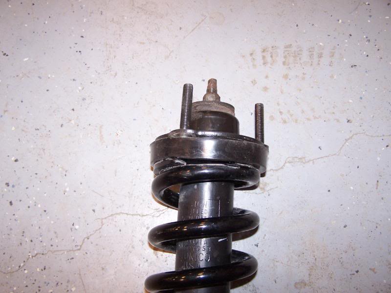

- press in new studs onto top strut mount
- install spacer between coil and upper strut mount and reinstall coil etc. 18 ft lbs for top nut.
- install tapered spacer onto top of strut
using an asistant again reinstall the strut assembly
- install lower strut mount bolt (100 ft lbs)
- using a floor jack raise the lower control arm and connect the upper ball joint on the control arm to the spindle torque nut to 40 ft lbs and replace cotter pin.
- reconnect the sway bar end links and remount to chassis.
- install wheels and lower vehicle onto ground and tighten up upper strut tower nuts to 35 ft lbs

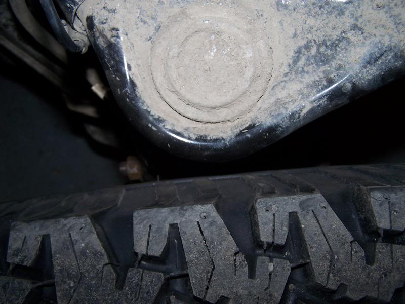

space between upper A arm and tyre. 3/4 inch
new measurement

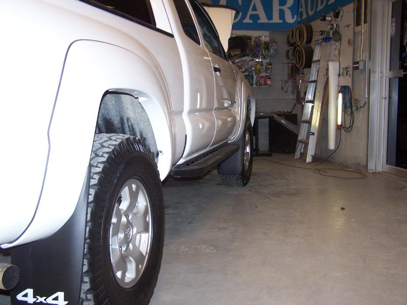

and theres your truck

the gear.
