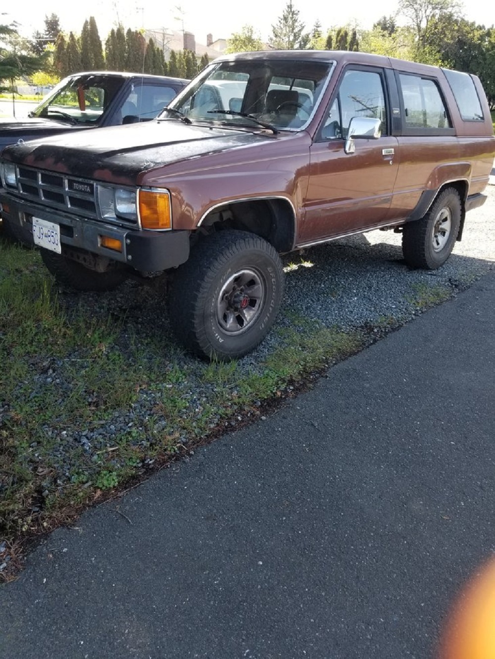

This is how she looked when I got it. Front end smashed in from him hitting something, different hood on it, front drivers fender is a replacement by some shop he took it to, missing a head light. That pic is the day before I drove it to work the first time, it tried to overheat on me on my drive home from work that day, so parked it and started researching while slowly straightening out the front end. Discovered he was running no thermostat to try and stop it from overheating, did not help. Put a thermostat in, checked fan clutch etc. Everything pointed to the Rad, but my buddy claimed it was brand new. Pulled it out, and sure enough a big dark brown spot in one of the bottom corners that I couldn’t see with it installed. New rad in, overheating issue fixed.

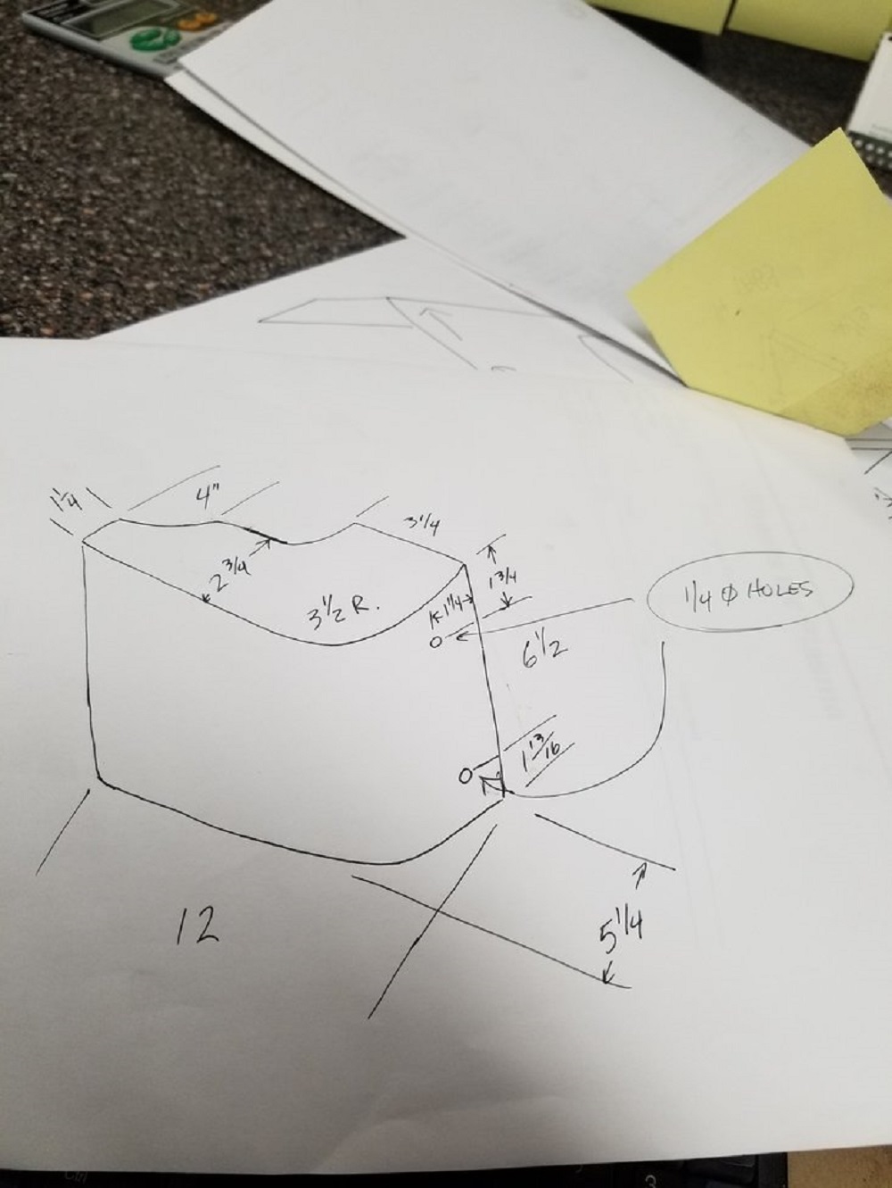

The juiciest bits of 5 Fists project 4Runner concern his custom fabrications. First up was bumper ends for each side of the truck. This was his initial sketch.

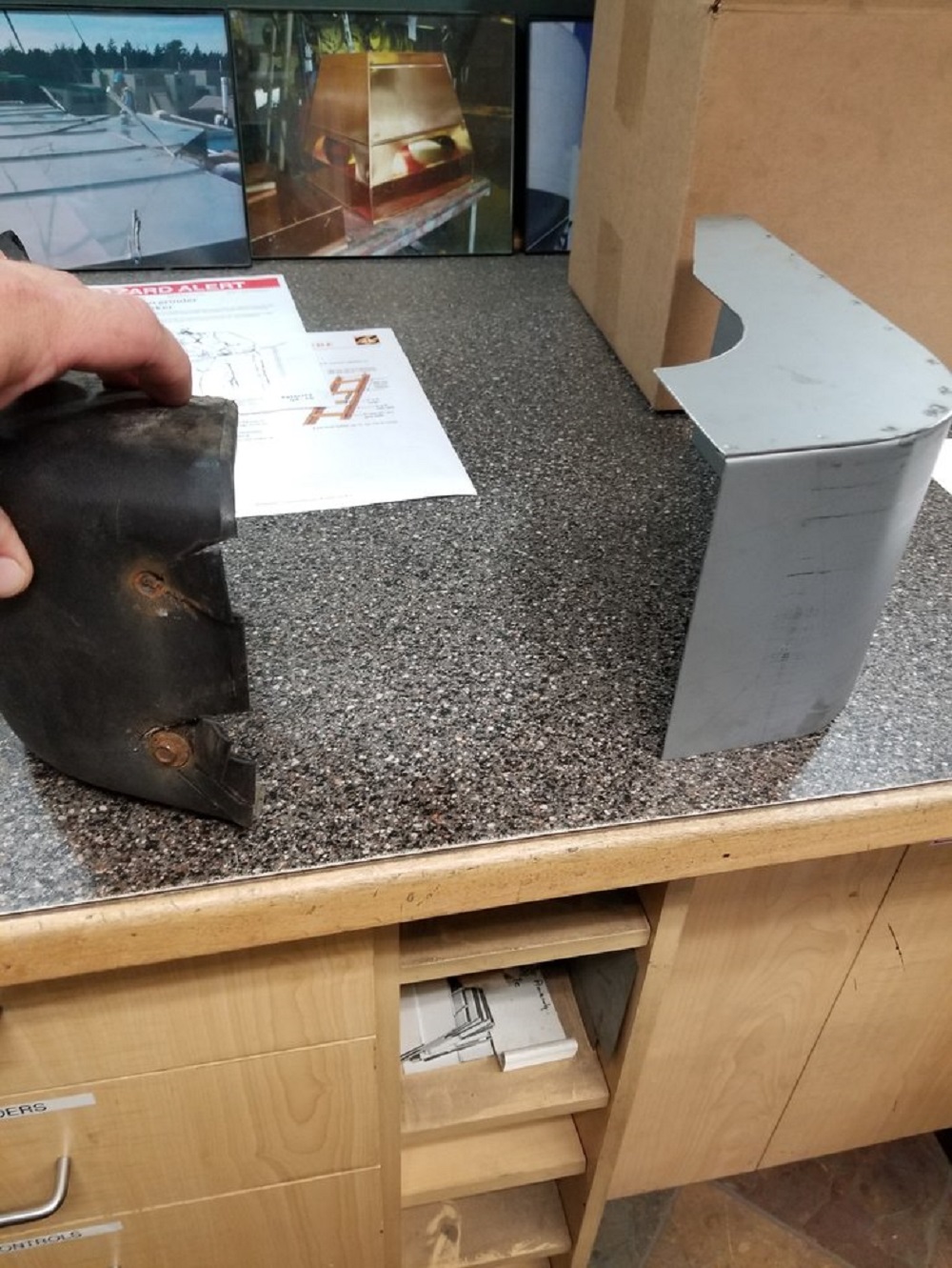

His first prototype didn’t properly fit, but that didn’t deter him one bit.
5fists 4runner

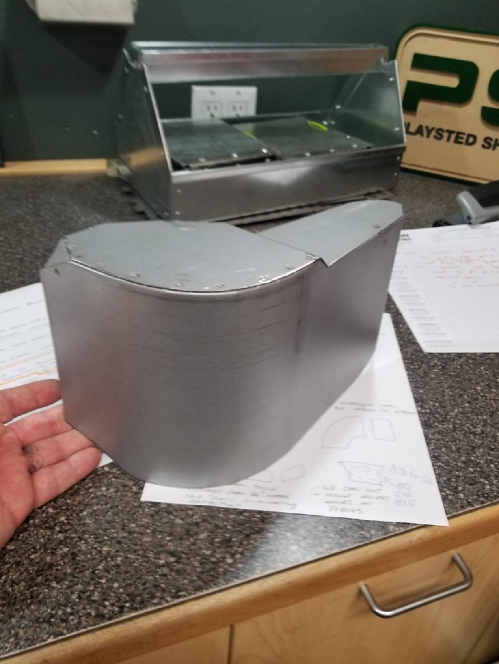

He made a second prototype too, and this time it worked! All he had to do was alter the build a bit so they fit under the bumper and angle corners for a better fit as well.
5 fists 4runner
His final build worked and he even painted the bumper ends black.
5fists 4runner
The result looks pretty great and as a bonus, the ends themselves are metal. His experience as a sheet metal worker helped him with the fabrication process.

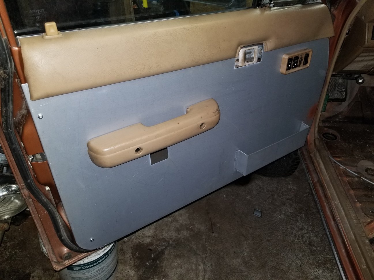

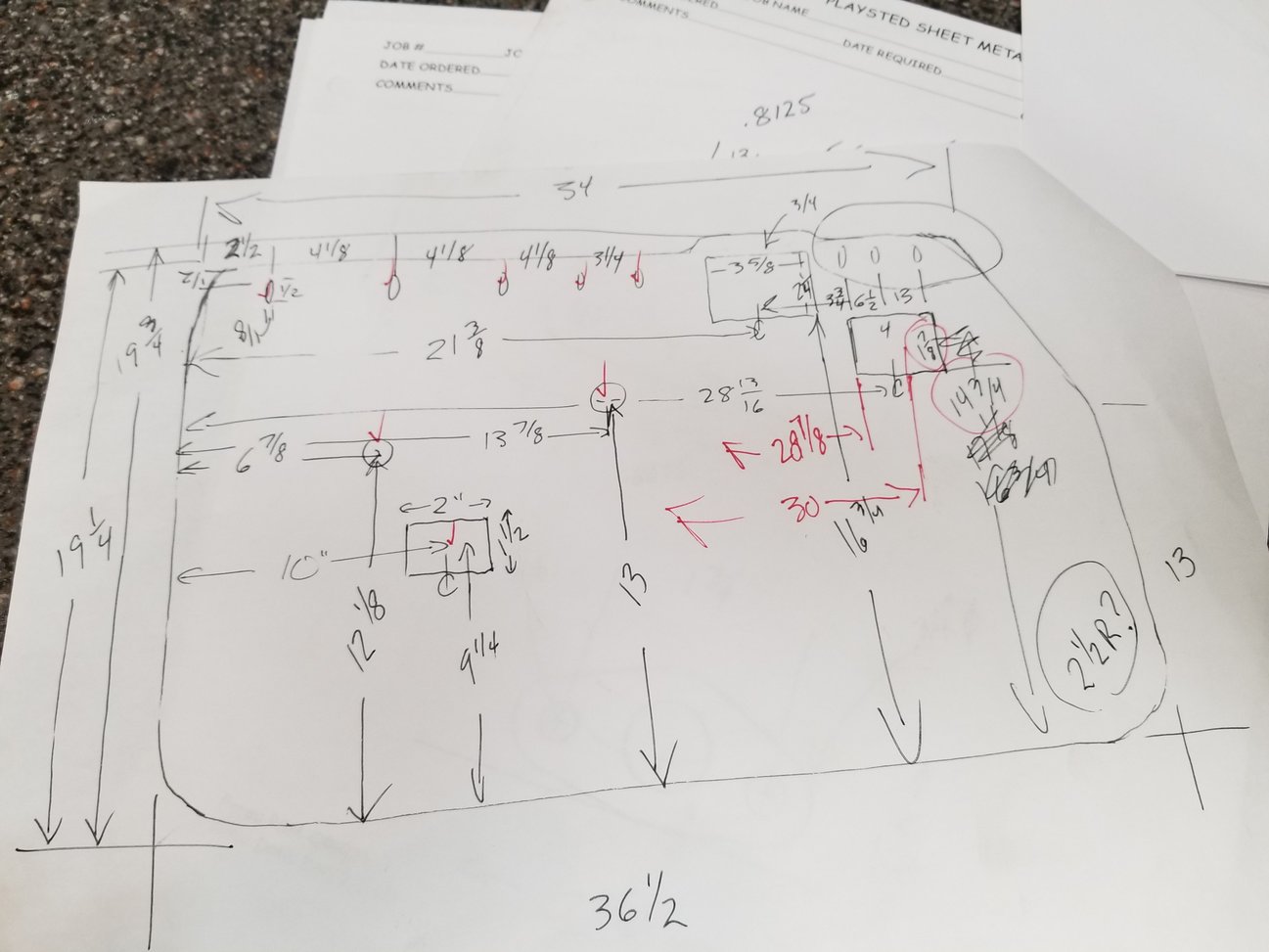

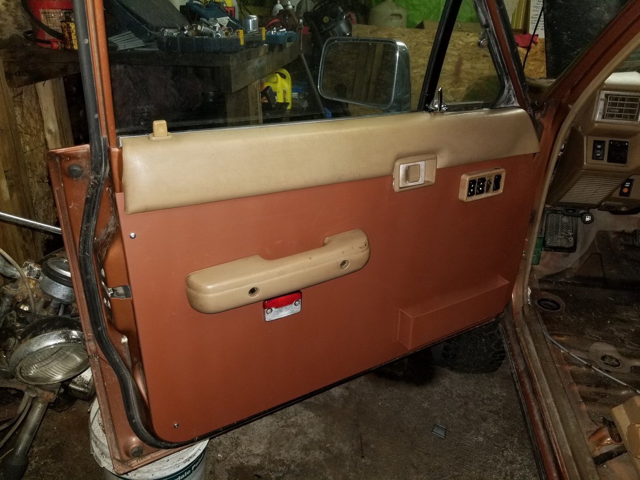

He then sketched out his plan to rebuild the door panels. Impressive stuff!
5fists 4runner
His first fitment worked out well.
5fists 4runner
And here’s the final product, adorned in red oxide primer to match the exterior paint of the 4Runner. He intends to build another set, but the ones he created look just fine and could plausibly pass as stock.

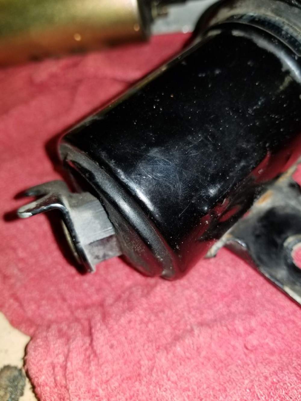

Truck wouldn’t start when I went to leave work one day. Confirmed spark and air, so disconnected supply side to fuel filter then jumpered to bypass COR and AFM circuit, only a sad little dribble of fuel came out. Picked up a new pump and filter, already had one side of filter unhooked, so might as well replace. This is how the old filter looked. Wasn’t leaking though.
Install new pump, go to install new filter.. and lose one of the Banjo bolts in the gravel parking lot at work. had to order one from the dealership, took 2 days, so had to leave her parked at work and take a company truck home for a couple days. Got the new bolt, new filter in, and fired right up. My pump must have been failing for a while, a new one solved a starting issue I was having.

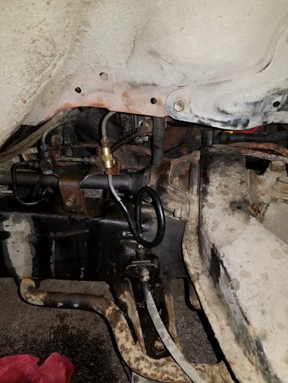

He also ran into some issues with his brake lines but thanks to the help of his fellow YotaTech forum members, he got his truck back on the road.

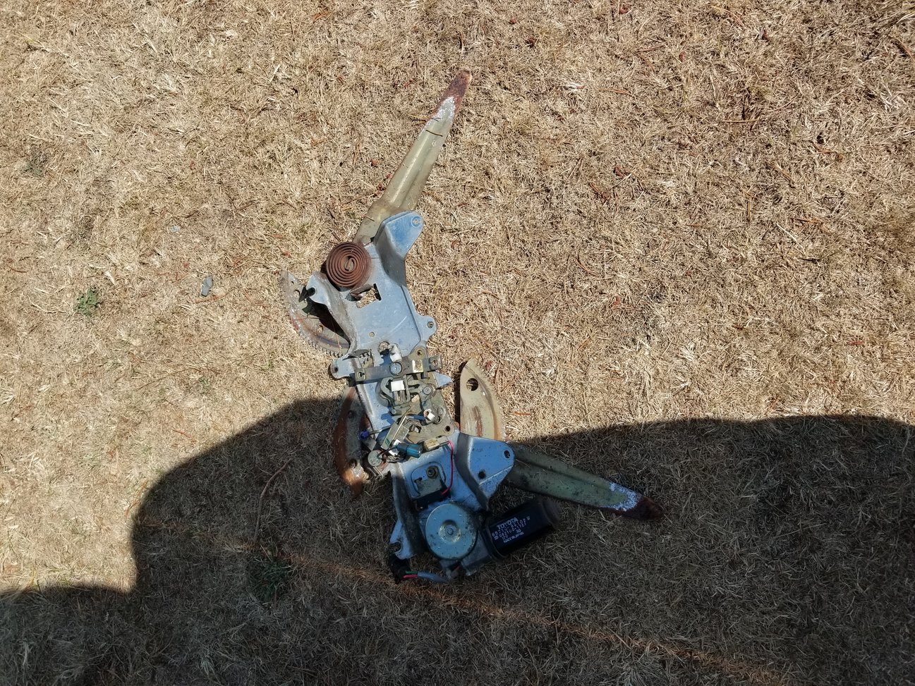

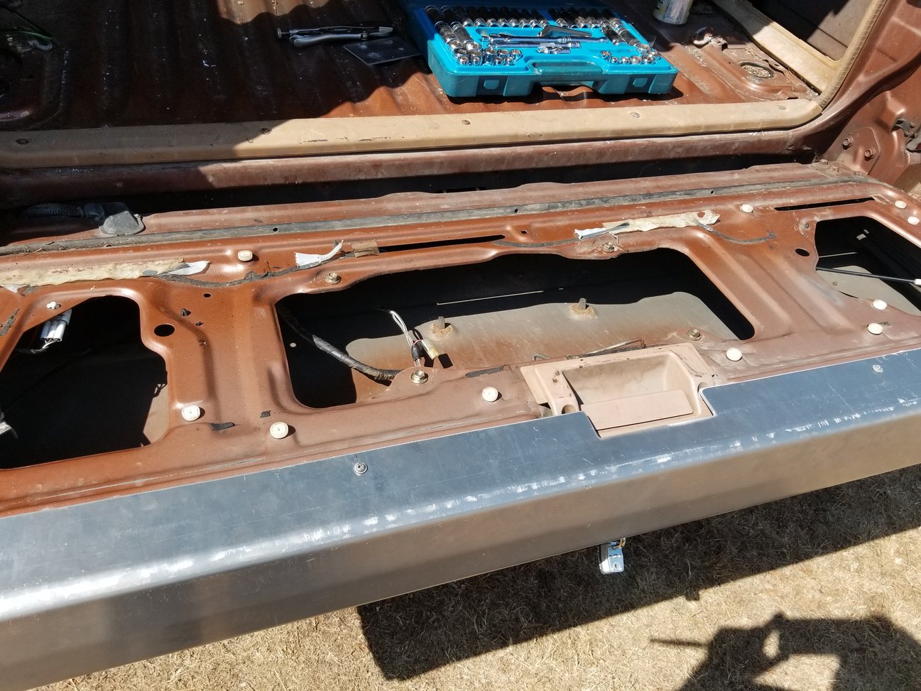

The next item on his agenda was the removal of the rear window motor and the regulator to make room for some additional storage space.
5fists 4runner
Powered accessories like the window motor and regulators obviously become more of a liability as a vehicle ages. And if you don’t actually roll the rear window down there’s no point in keeping it. Plus, just look at the size of the motor! No wonder he wanted it out of his truck.

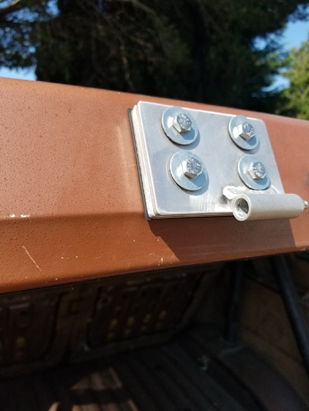

He also plans to replace the rear window with a better fitting one, hence the new hinge.

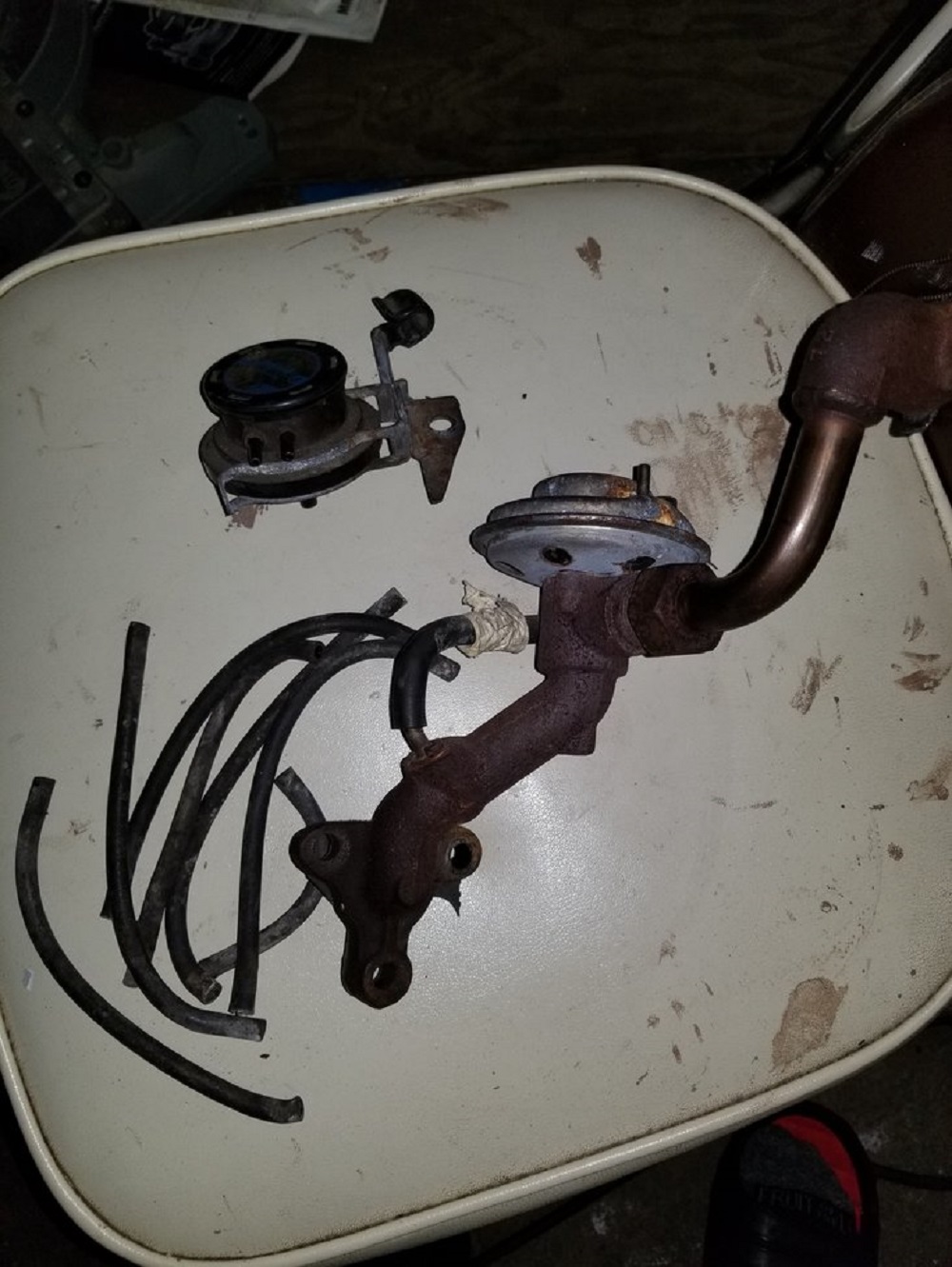

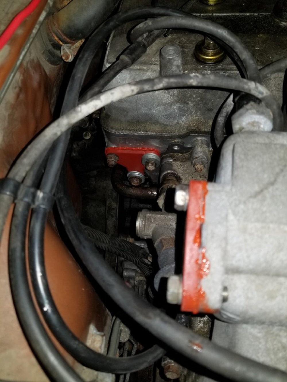

He also removed the EGR valve.
5fists 4runner
There were some benefits to removing it too.
I am convinced my EGR was non functioning, with the increased throttle response and smoother running at cruise I am getting now.

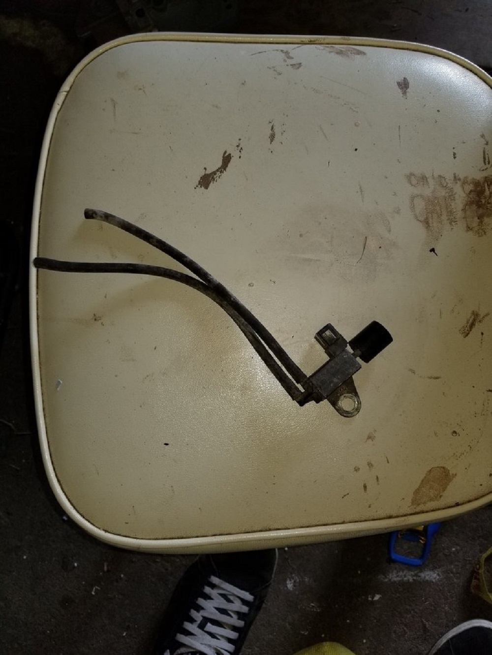

5 Fists also plans to remove the air conditioning system.
Removed A/C idle up VSV and capped vac ports, as I will be removing all factory A/C components soon.

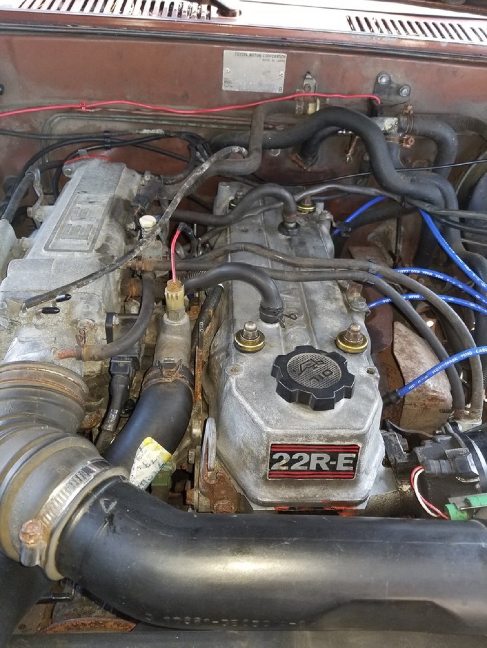

He also performed some engine maintenance.
Also did my Valve cover gasket and half moon grommets, as I had a slight leak from doing my valve clearances awhile ago. Gotta say, taking the valve cover off without the mess of vac lines is stupid easy now.. not that was all that hard before, but wow.. could do it with my eyes closed now! Gave the cover a quick clean too, doesn’t look as terrible now!

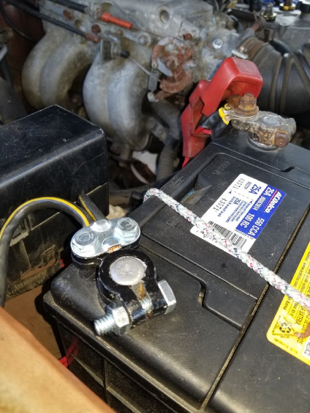

Battery terminals are also a priority and he’s done one so far.

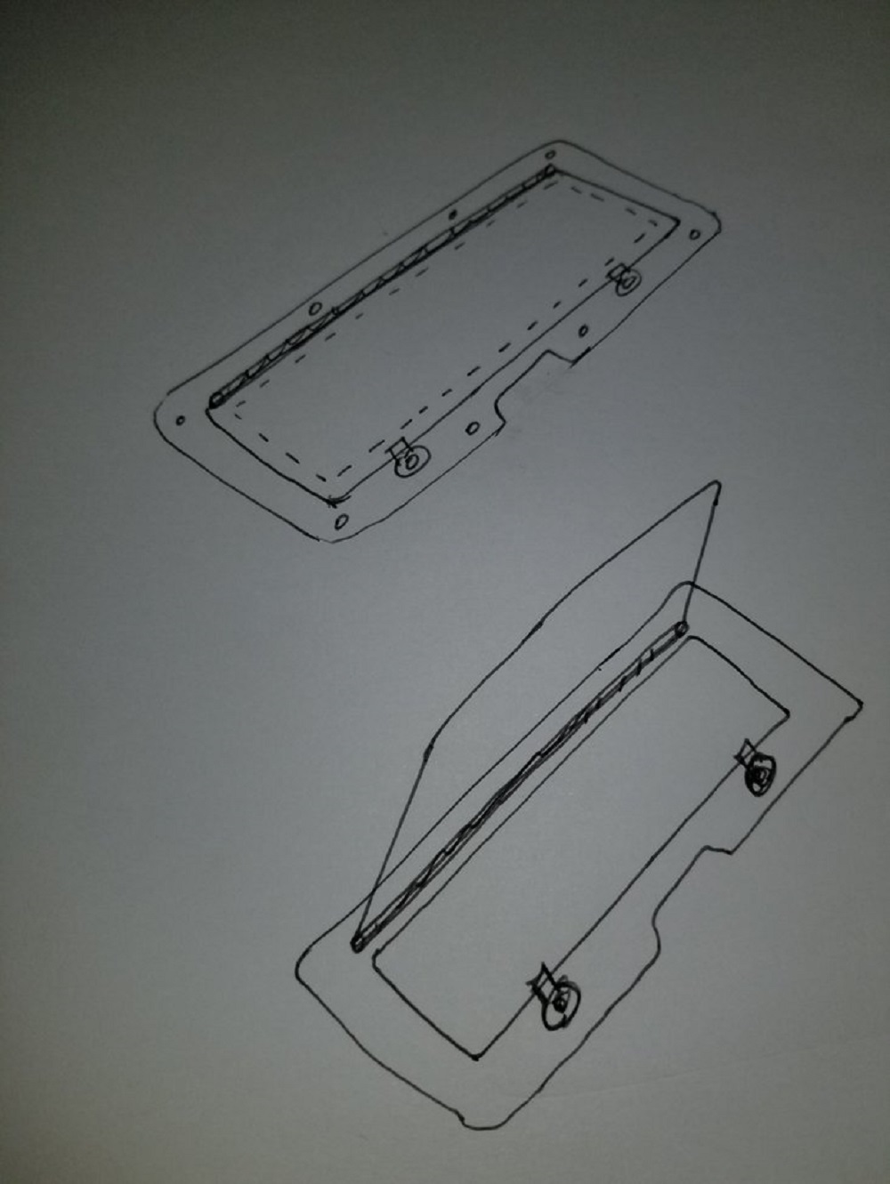

What’s planned for the future? Closing up the holes created by removing the power rear window components with some nifty doors, complete with latches!
5 Fists is off to a great start with his 4Runner and he’s already given the truck a unique look with the bumper ends. There’s bound to be more awesome sketches and fabricated parts in store for everyone to enjoy. He’s looking for some input into his rear door project, so if you’ve got some advice for him, make sure to head over to the thread and contribute your two cents. I’m sure he’ll appreciate it!
