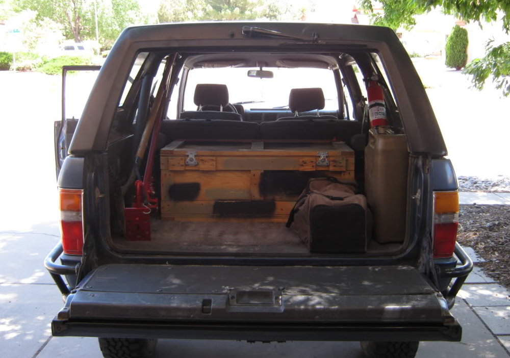

If you have been thinking about adding some big bass speakers to your Toyota 4Runner, this old-school YotaTech forums write up by “Bob_98SR5” offers a great deal of insight on what you will run into while modifying the cargo area to add speakers without killing the cargo-hauling capabilities. Sadly, the thread is 13 years old and the once-linked images are gone, but we found some general images on the site of an early 4Runner, similar to the one that would have been used for the initial project thread.

When the OP first posted his thread in the Tech Write-Ups section back in January of 2006, he included an array of pictures of his own vehicle with the added speakers, or at least that is what he seems to have included. The pictures have long-since stopped loading from wherever they were hosted, so all we are left with is the written information. Fortunately, that is more than enough to give a Toyota 4Runner owner a good idea of what goes into installing 10-inch subwoofers into the storage spaces in the rear of the cargo area.
