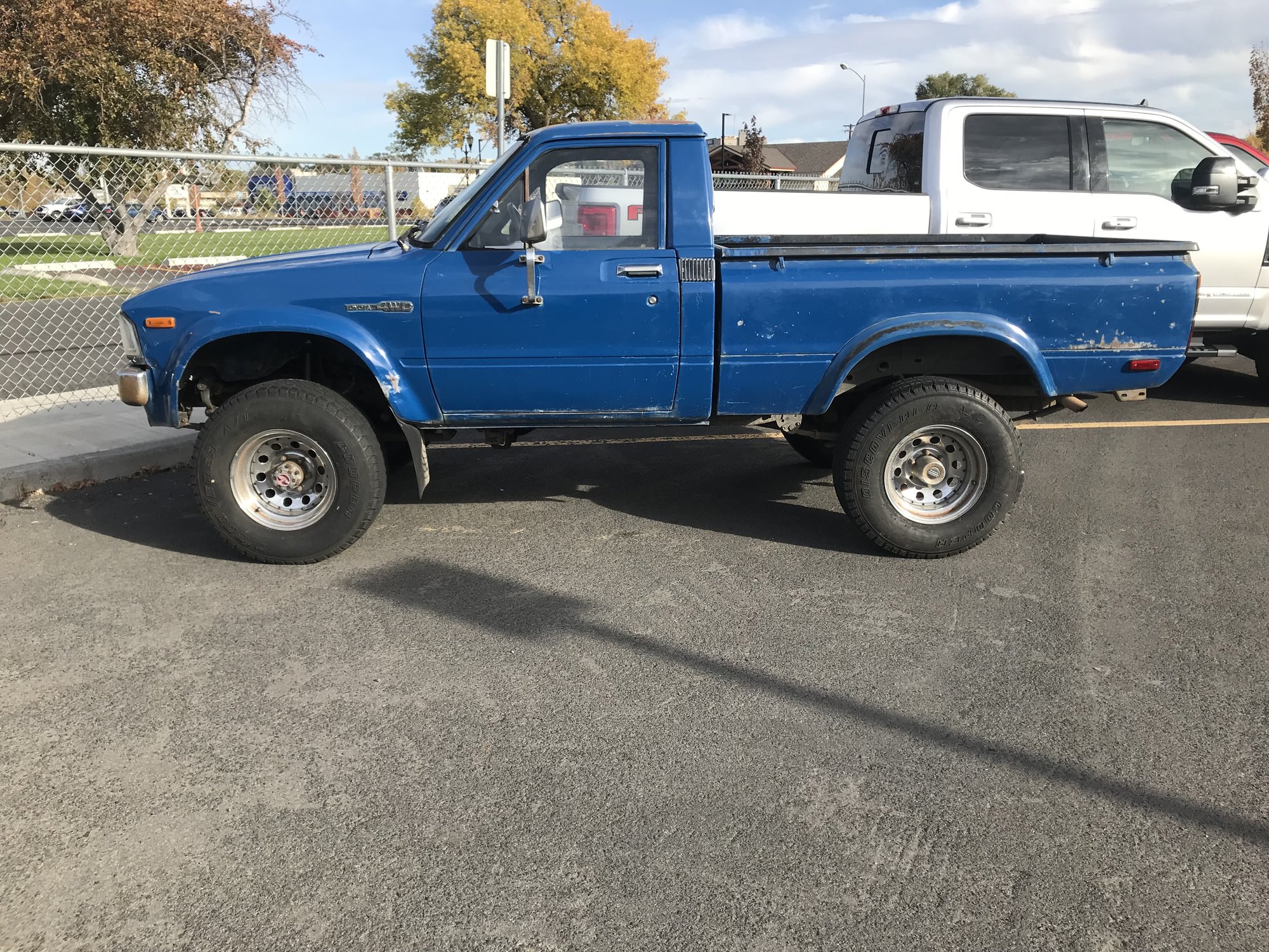

sent112 started the thread by talking about his newly acquired ’82 pickup:
Recently picked up this ’82 with the intention of restoring it. I had one over 30 years ago and have kicked myself everyday since for getting rid of it. Anyway it had the stock skinny pizza cutter wheels on it when I got it but a buddy gave me these wheels and tires from his ’82 Chevy pickup. The tires are 31’s and it looks like there is still quite a bit of clearance.
Has this truck been lifted and what can I look for to give me the answer?
81 4X4” then responded with an uncontested answer:
I would have to say yes. It’s not much, maybe just an add a leaf kit, or some aftermarket springs. I would guess no more than 1 to 2 inches, or 3 inches at most.

sent112 replied with a brief outline about what he’s already done to the truck and what he wants to do in the future:
Back springs are “U” shaped and the front ones are about flat. I just bought some cheap KYB’s for now as the one that were on there were totally gone. So these are know for the rough ride? My ultimate goal is to put 33″s on it with a 3″ suspension lift like I had on my old one. What do you guys recommend for a suspension lift and are there any out there that provide a little softer ride? I been out of the game for a long time…
