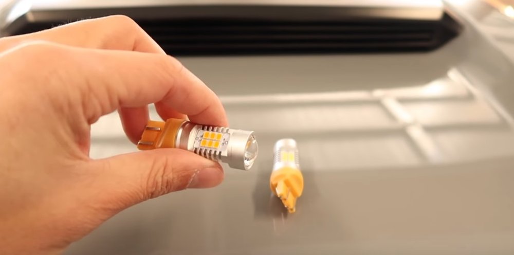

In any case, he begins by explaining the project and giving us a look at the JDM AStar LED bulbs that are being installed. He explains that the swap is “super easy”, as the bulbs on the 2016 through 2019 Tacoma are conveniently located under the hood, so there is no “squeezing your hand through anything” to access the bulbs.
Tacoma LED Turn Signals
We also get a look at the bulbs with their built-in resistors, which help to prevent “hyper flash” that comes with some cheaper LED replacement bulbs.

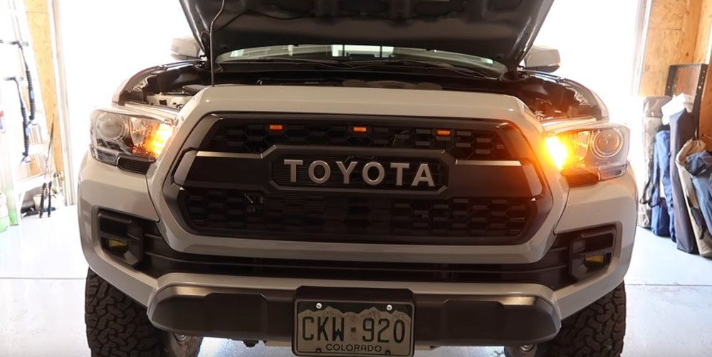

Once the video host has popped the hood of his Toyota Tacoma, we get a look at the location of the turn signal bulbs, both of which are easily accessible. The stock bulbs are removed by twisting the plug counter-clockwise and pulling them out of the harness plug, while the new LEDs plug right into place without any special preparation. It really is as easy as pulling the plugs out of the headlight assembly, pulling the bulbs out of the plug, inserting the new LED bulbs and replacing the plug next to the headlights.
Tacoma Turn Signal Location
Once the host has changed one, he shows the difference between the stock Tacoma bulb and the new LED, and that difference is remarkable. As you can see in the image below, the LED is far brighter and in the video, you can see that the LED blinks much more quickly. The standard bulb almost fades in and out while the LED blinks sharply, making the new turn signals much more noticeable.
Tacoma with Two Different Turn Signal Bulbs
