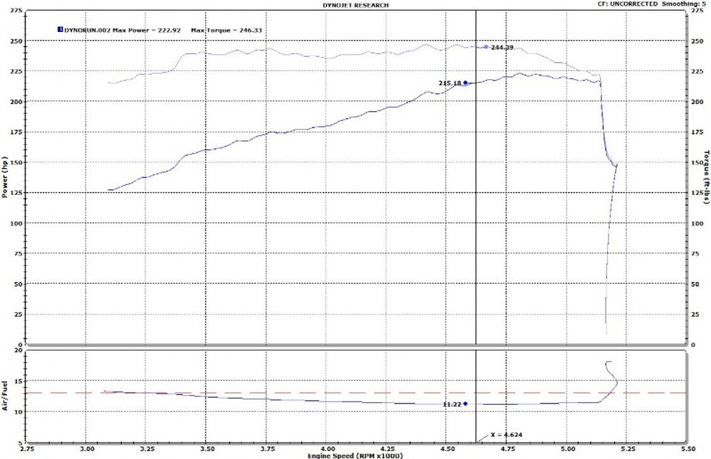

The OP pointed out that his 2000 Toyota 4Runner had a TRD 1st generation supercharger, a URD 7th injector kit/ECU kit, a set of Doug Thorley headers and the required gauges and tuning tools. With this setup running on 5 pounds of boost, this SUV made 222 horsepower and 246 lb-ft of torque at the rear wheels.
He later hit the dyno again with a smaller pulley and more boost, but with that better pulley, the blower belt was spinning and he was losing boost. As a result, the 4Runner “only” made 226 horsepower at the rear wheels, but he speculates that without the belt slip, his Toyota could have gotten into the range of 230-240 wheel horsepower.
Keep in mind that with 183 stock engine horsepower, this 4Runner likely made around 150 wheel horsepower (using an 18% drivetrain loss factor), so at 226, this Toyota SUV has picked up roughly 76 rear wheel horsepower from the headers, blower and tune.
4Runner Dyno Sheet
