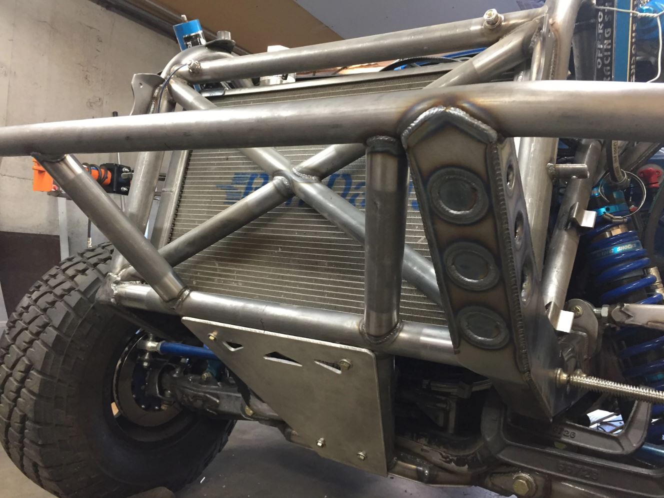

He kept the engine, since desert races call for the motors in trucks to be stock. Interestingly enough, Walter didn’t add too many bits to the engine, either. He made a custom air intake for the engine, and that’s about it. Next order of business was to replace the transmission. Instead of the six speed, Walter fitted the truck with a GM TH400 manual reverse patter automatic. Not surprisingly, the transmission wouldn’t directly bolt up to the engine — so Walter crafted his own adapter to mate the two. In regards to the torque converter that was now needed, that was custom made through TCS Performance Products.

In Headlee’s interview, the most interesting part of the suspension conversation was Walter’s foundational mission for the front suspension. Walter said that for his truck, he prioritized clearance and not sheer height. As a byproduct, the truck is lifted by four inches. So, how did Walter design the front suspension? Well, through the fairly complicated use of computer-aided 3D draft software and animation software.
Through the 3D program, Walter would design a 3D model of suspension components he designed. Then, with the animation software, he’d run it through virtual tests to observe his design’s competence (or, lack thereof). Through this process, he was able to pinpoint his perfect set up. The upper and lower control arms and the knuckles within are all Walter’s work. Naturally, Walter went with King Off-Road 2.5 Coilovers, 3.0 3-tube Bypasses and 2.0 by 2-inch hydraulic bump stops. To keep the Tacoma and its custom set up

Not ready to slow down, Walter also hand made cage with two inch thick steel tubing. He was also careful to fabricate a way to remove the custom driveshaft should it get damaged during a race. In the interior, the dash and comfortable seats were removed to make way for some upgrades. For the seats, he added two Sparco racing seats with five point harnesses. The dash, which is a modified Fiberwerx set, was cut to split into three pieces to make maintenance simple.
Additionally, the skid plates in the front were born from Walter’s talent, along with front and rear steel bumpers. The bumpers were made with a friend who’s equally talented. It’s nice to have friends who also happen to be genius fabricators.
