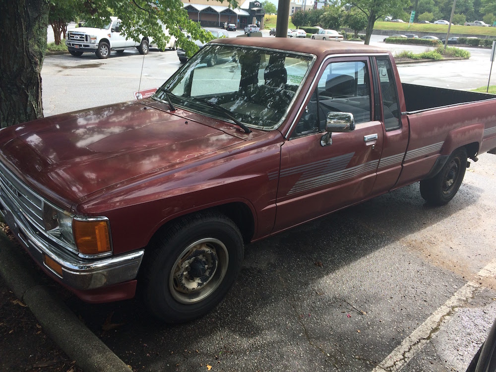

I looked around slightly confused. Then it dawned on me, he meant his truck. There sat a gorgeous, nearly-stock 1987 4×2 Toyota pickup. The lone modification was a Weber carb. I was at a total loss for words. I had never even casually admired an old Toyota truck, but here I was–awestruck. It was gorgeous. It was truly love at first sight.

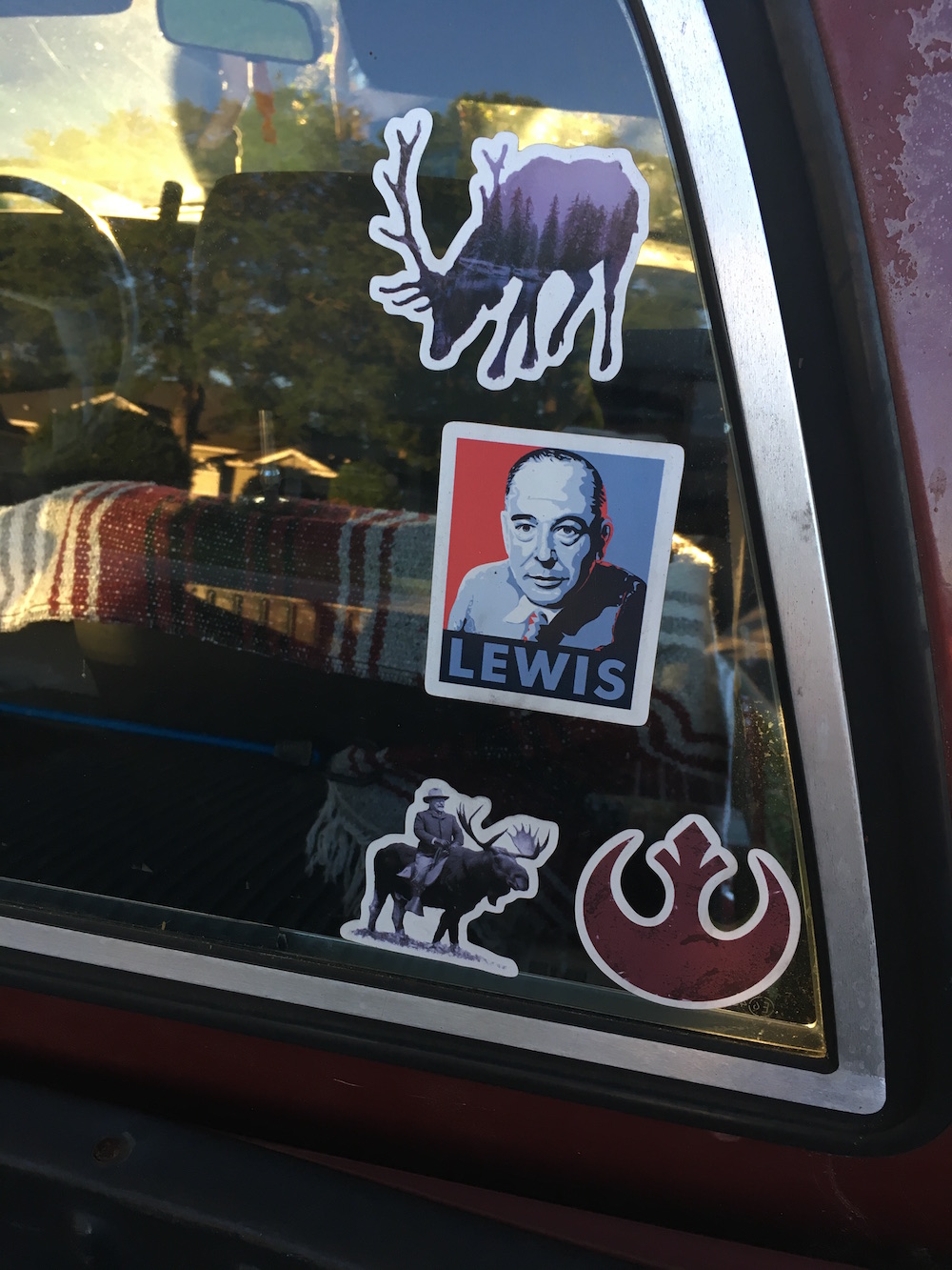

Shortly afterward, I did my usual sticker placement. This has become a ritualized rite of passage for all of my vehicles. This is no exaggeration, I spent several hours online looking for the right stickers to fit the personality of both myself and the truck. And to help further my business, I also custom-ordered decals for the tailgate.
After they arrived, I played around with placement options. I settled on a layout I felt suited the truck and released a great sigh of accomplishment. This truck was mine. For the first time in my life, I truly felt like I had a vehicle that fit me.

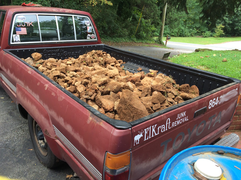

I quickly began taking on various junk-removal jobs, several of which more than stressed the under-powered yet reliable 22R engine Revan housed. Revan wasn’t peppy by any means, but the long bed more than made up for any time I lost on the job site. And the engine held up just fine.

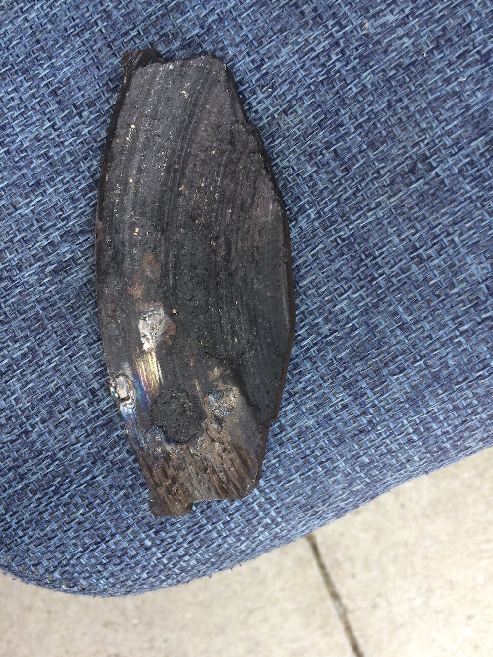

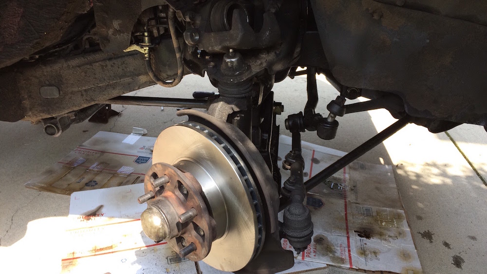

One day as I was towing a small loaded trailer, I applied my brakes and felt a godawful crunching. I knew something wasn’t right. Luckily, I was close to home. I parked the trailer and pulled into the driveway to inspect.
When I laid eyes on the culprit, two things went through my mind:
  1. I’m stupid.
  2. That’s not good.
I had completely overlooked checking the brake pads when I acquired Revan. Like an idiot, I assumed the pads had squeal indicators. Don’t they all? Nope.
My first Toyota: Skimpy pad
One pad had worn down so thin that it slipped out of the bracket and lodged itself between the caliper bracket and rotor. It gouged ravines in my rotor like the Grand Canyon.

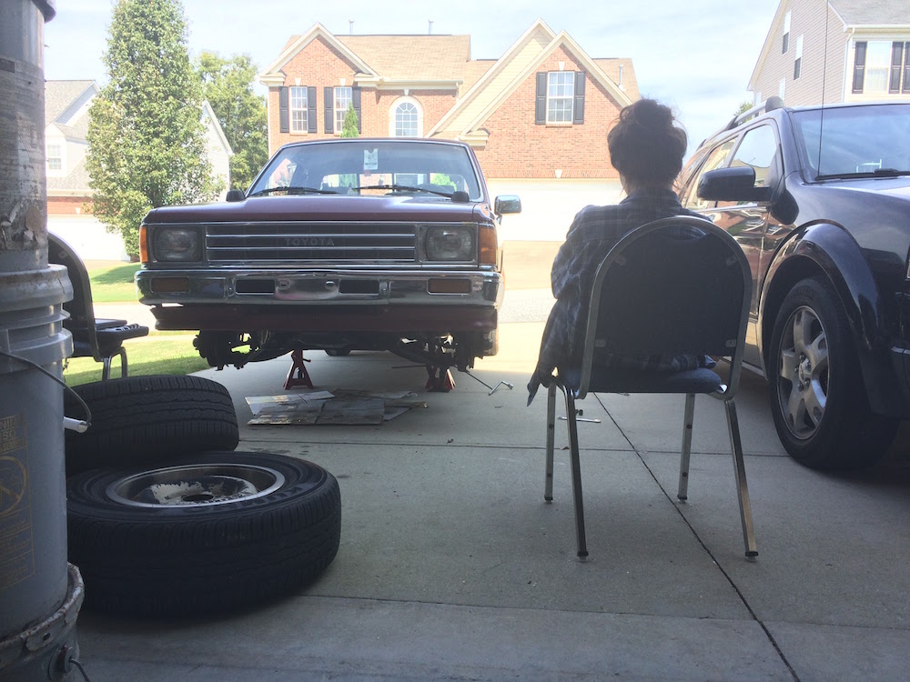

Over the next few days, I replaced both front rotors and all pads, bled the brakes, and re-greased the slide pins and bearings. It was a lot of work for someone with my lack of experience, but I learned a lot. After I got everything running properly, I felt so accomplished.

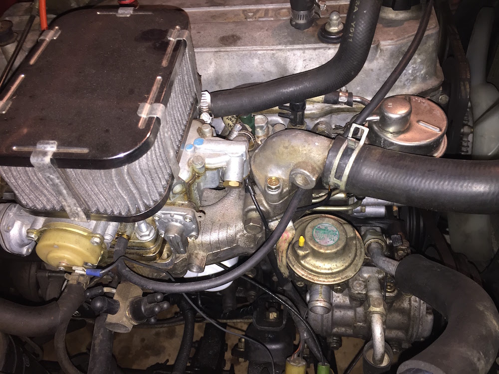

My first Toyota: Weber Carb

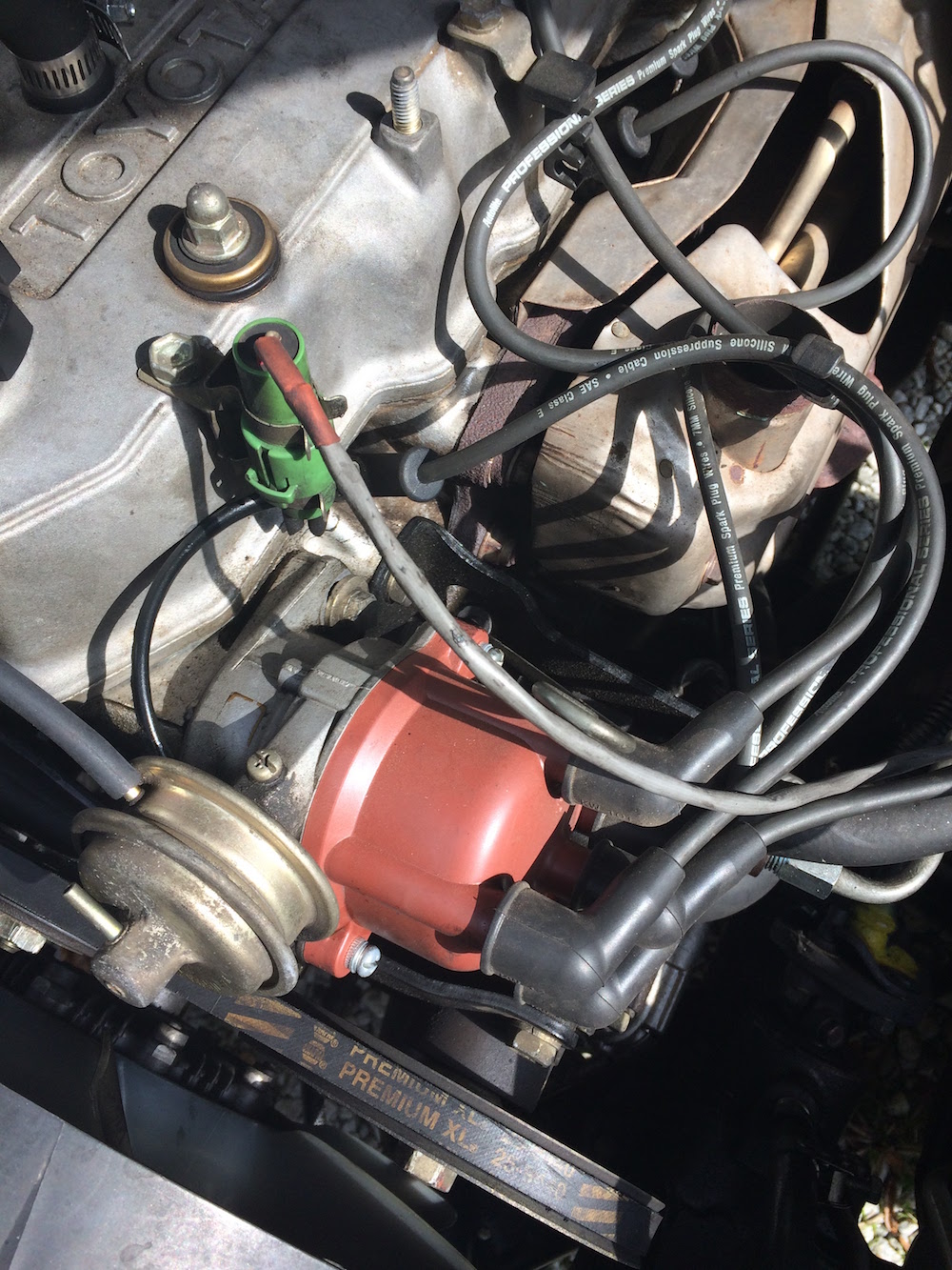

As time went on and I began to rack up the mileage, Revan naturally needed maintenance work. Unfortunately, I was unaware of one of these needs in particular. This cost me a lot of money and many headaches. But once again, I learned a great amount.
One day I was driving and noticed that my truck was responding a bit sluggishly. I searched in my Haynes manual and online trying to nail down the problem. I worked my way up from the cheapest fixes in an attempt to remedy the situation.
First I replaced the fuel filter. This did nothing. I then replaced my spark plugs, wires, and distributor cap. Still, nothing. I then replaced the fuel pump. The hesitation persisted. I was at a loss for what it could be.
Then one day my truck started running hot. This added to my frustration as I couldn’t understand what was going on. Like I said before, I was new to this. I ended up replacing the radiator cap, suspecting it had a pressure leak. I also replaced the thermostat and coolant.

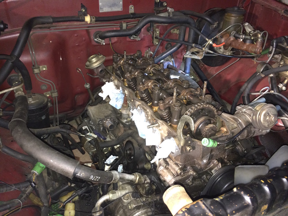

Revan began running even worse over the next two weeks. Finally, it occurred to me to check the oil. I removed my oil cap and found it was covered in chocolate milk.
The Rebuild
YOTATECH: My First Toyota, by Tyler Linn

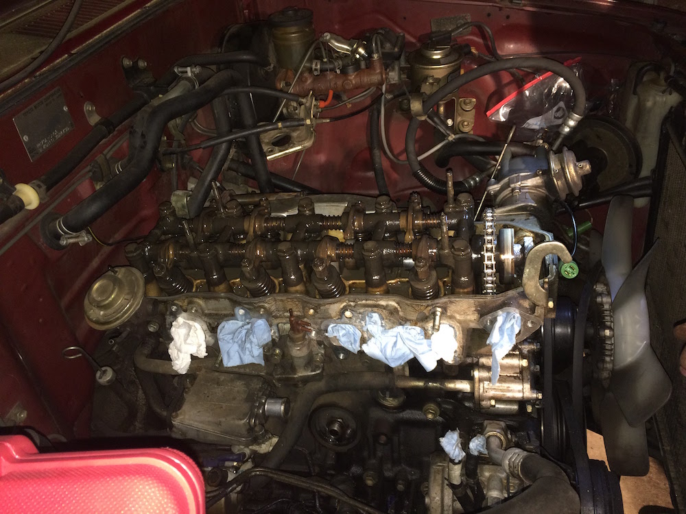

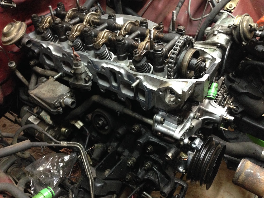

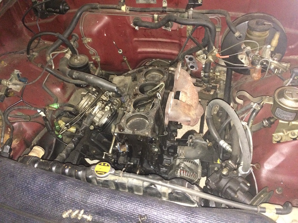

My poor 22R had coolant and oil mixing. I had driven it like that for two weeks! Even while overheating many times in that span, it still kept running. After that experience, no one can convince me theses trucks aren’t bulletproof.

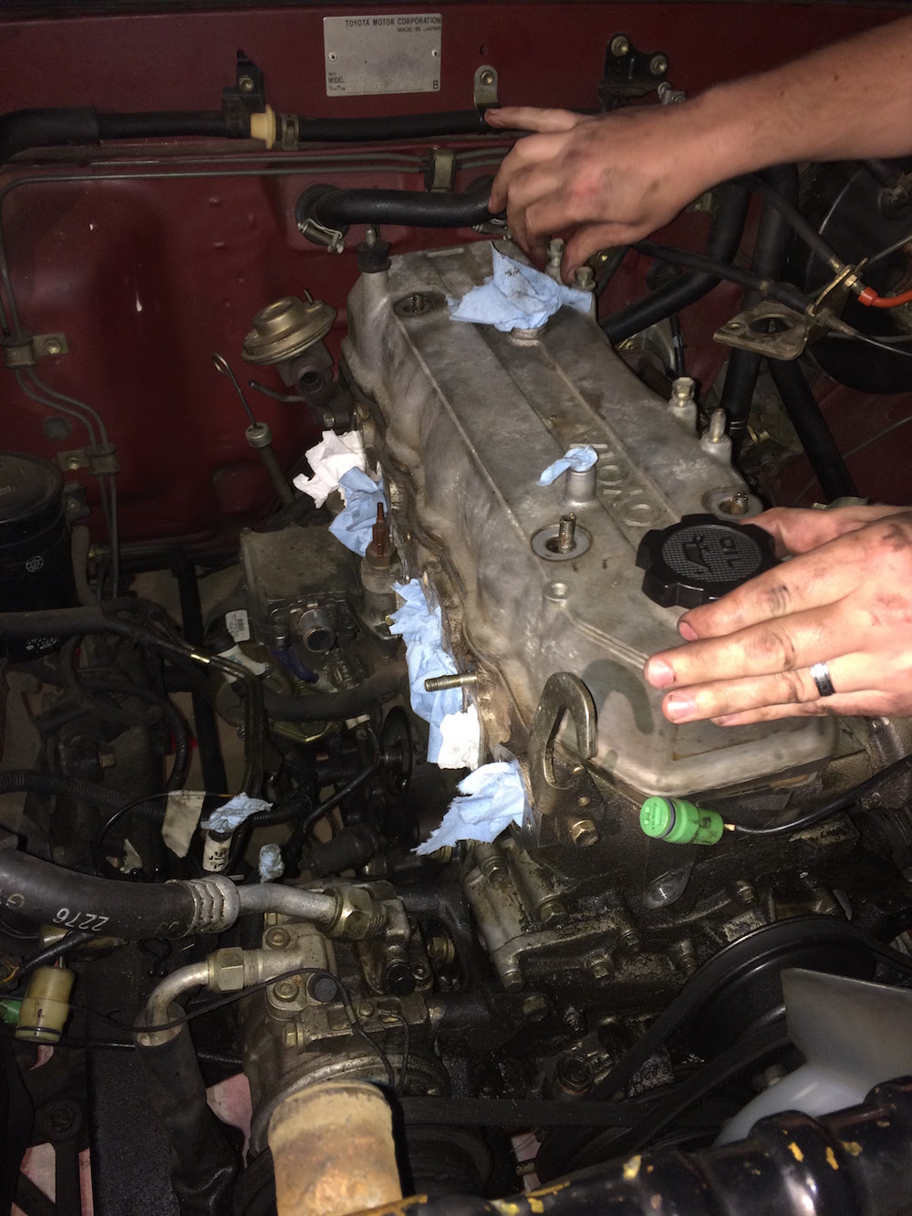

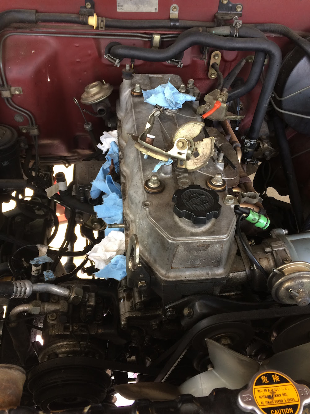

I had Revan towed to my home and I began working. My brother-in-law came over and we quickly removed as much as we could. We pulled the carb, intake manifold, valve cover, hoses, belts, and more. I felt uncomfortable proceeding any further with my limited knowledge, so I sent Revan off to a shop to be finished up.
The culprit was not the head gasket as I had first assumed. It turned out to be the timing chain. Right on time (around 140,000 miles) it loosened up and wore through the plastic chain guides. After doing so, the chain loosened further and wore a small hole in the chain cover. Oil and coolant were now desegregated.
Despite my misfortunes, I grew to love Toyota’s core principles of durability, reliability, and quality. When taken care of, these vehicles will last a lifetime. Even under severe abuse, that 22R kept going.
I bought the necessary replacement parts from Buck’s Engine Parts, a local shop in South Carolina. This constituted a new chain, metal-backed chain guides, water pump, oil pump, and gaskets. I brought them to my mechanic, Dallas, and let him work his magic.
Remarkably, the head hadn’t warped at all from the overheating. Nevertheless, we sent it off to get resurfaced anyways. After it came back, Dallas put everything back together and got Revan running again. He charged me a mere $500. I was greatly relieved to have my truck back and my bank account still intact.

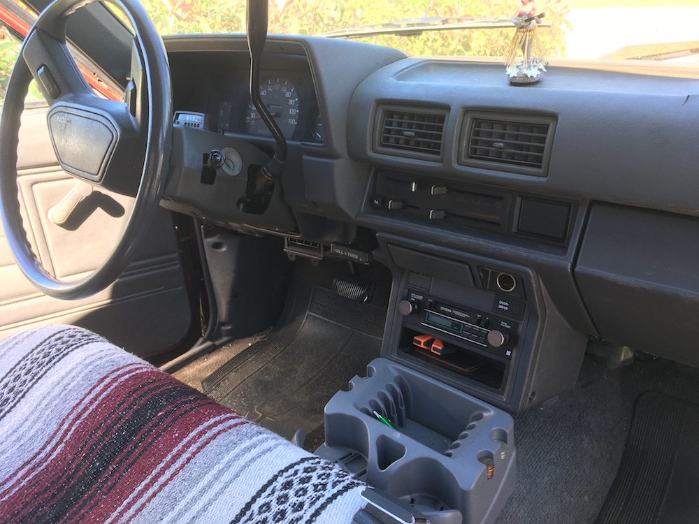

I also installed a small console on the floorboard where a stick might have been, had it been a manual.

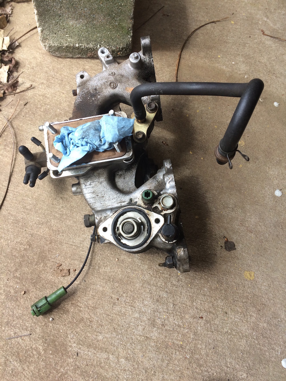

My first Toyota: LCE EGR block-off plate

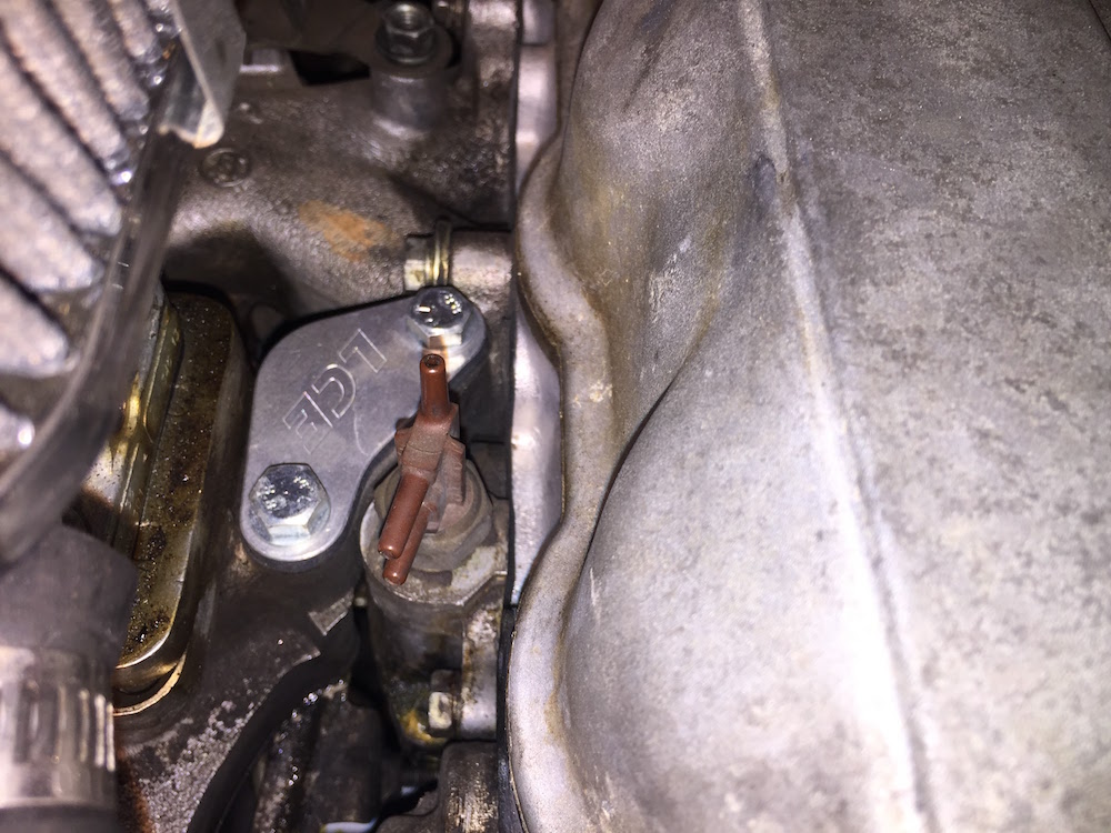

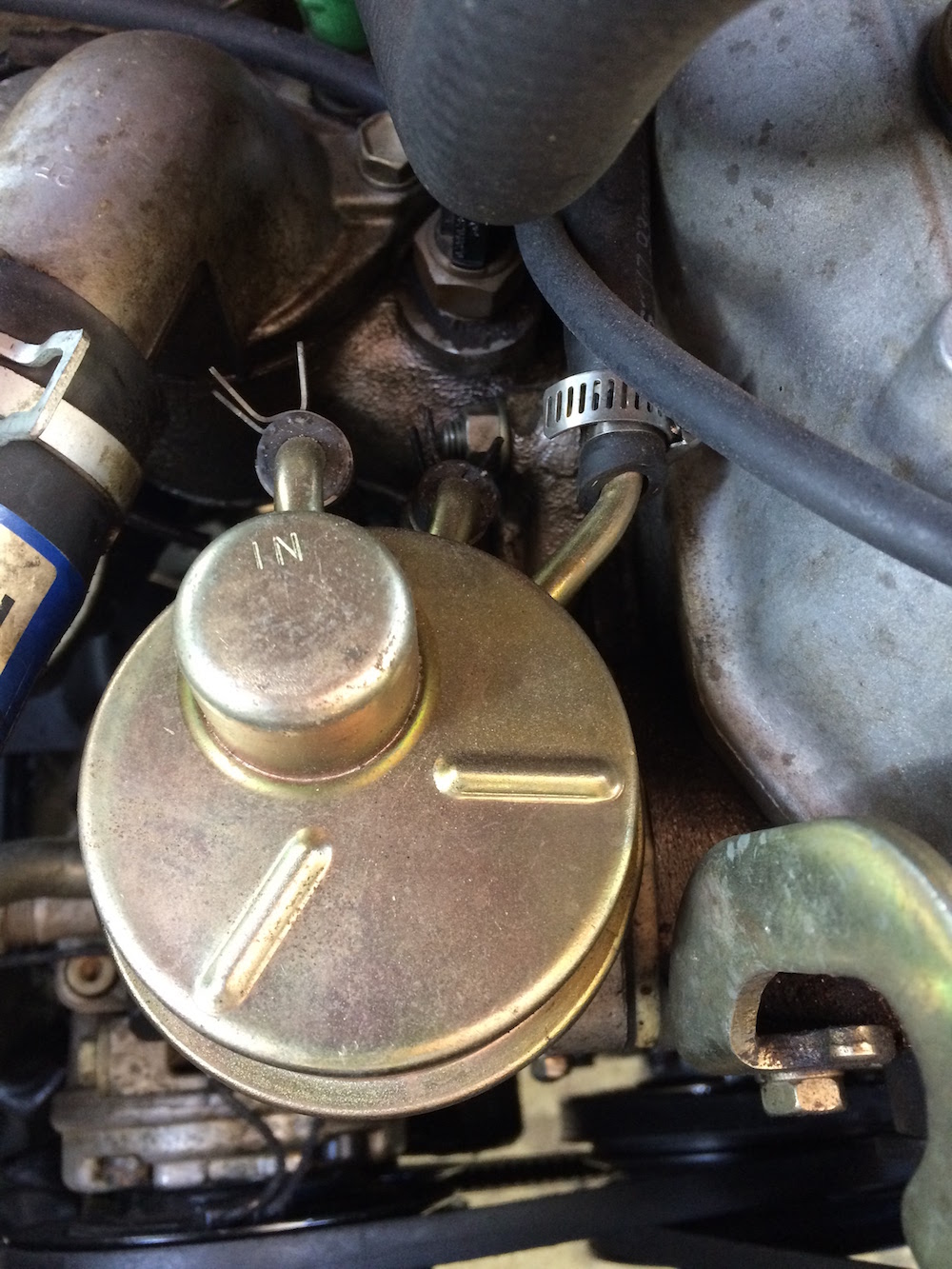

To aid performance I performed a small desmog operation on my ’87 Yota. I removed several parts that the YotaTech forum members deemed unnecessary, and their respective hoses. On top of that, I replaced my PCV with a breather. But, my favorite performance mod was installing EGR block-off plates from LCE.

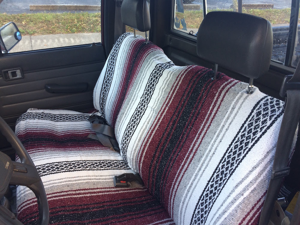

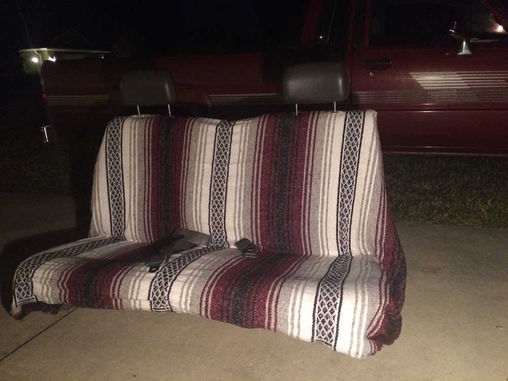

Visually, I didn’t do anything to Revan. I liked the rough look of my older truck. I did, however, make a custom seat cover. This was one of my favorite projects. I purchased a grommet kit and a Baja blanket and got to work.
I removed the seats from the truck and gauged how the blanket would best serve as a cover. Subsequently, I cut holes for the seat belts and installed the grommets. I then attached the cover.
I was really digging the look of this mod. After reinstalling the seats, my wife Jess and I took Revan for a night drive, captured in the picture above.
