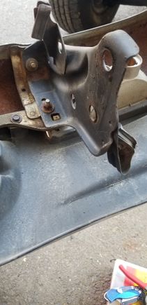

8784 runner April 22, 2018
So the bumper did take slight modifuing to go on. Cause of the intercooler but mainly the body lift. Unfortunately i do not have a after pic of what this bracket looked like whenni was done in order for to go on. But about 1/4" below each hole i drew a straight line and had to cut off a chunk of the bracket in order for it to get to its stock location.
