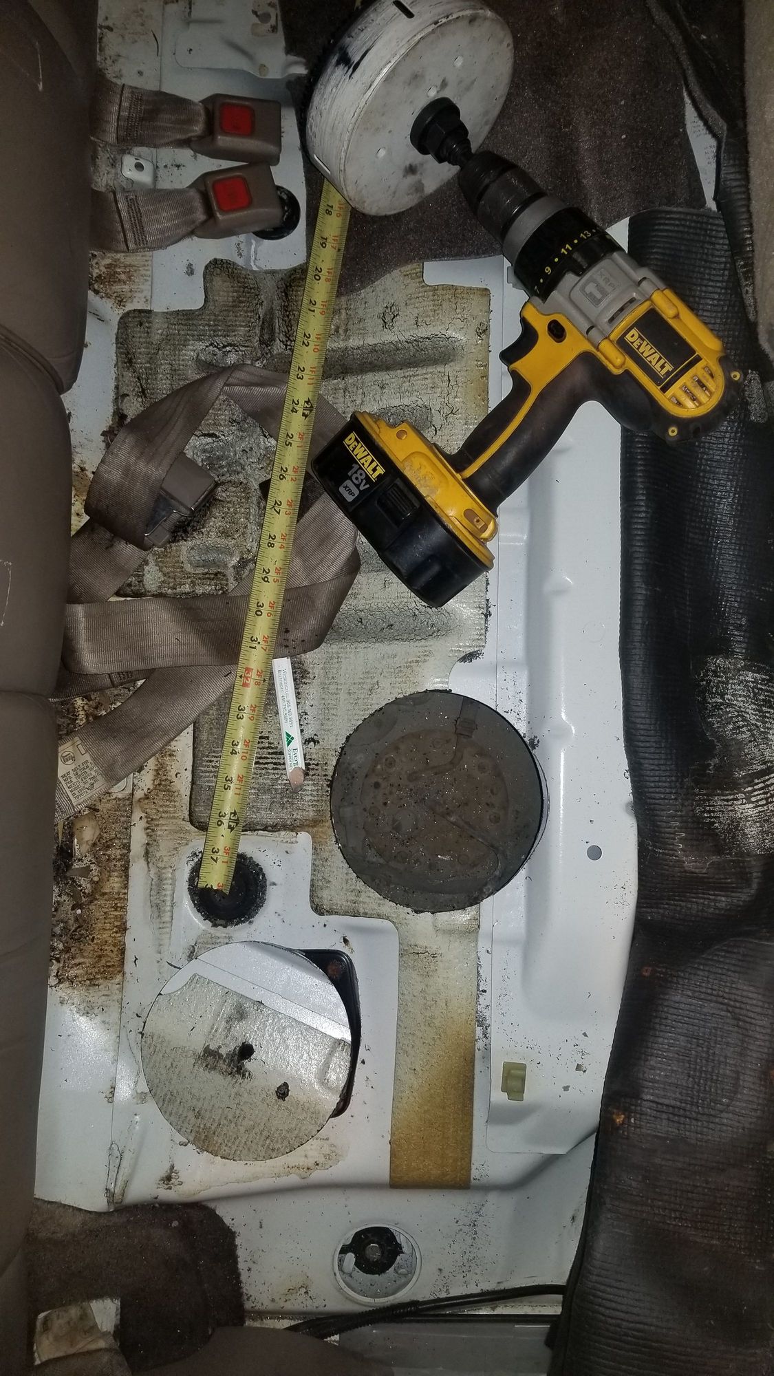

Since everything i do is bymyself crawling around the garage floor i decided i was NOT dropping the gas tank. So i used a 6inch holesaw to get to it instead. Far far eaisier and quicker Cureently i sealed the metal edge with a hard set epoxy and then weath stripped a piece of aluminum over it. Pull the carpet back and you would never know it was thier
