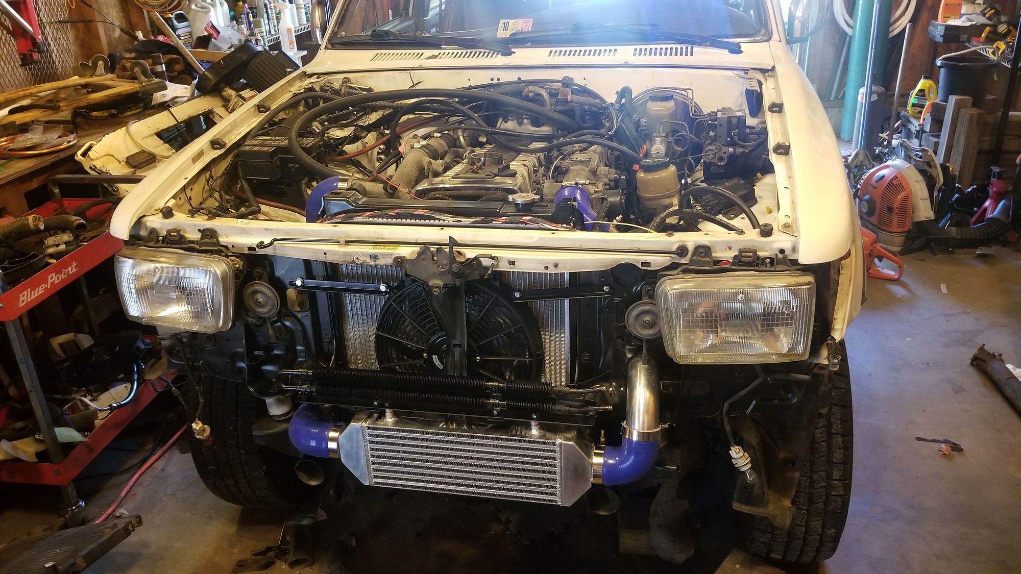

Here you can see power steering cooler bolted up above the intercooler as well as the elctric fan. I really do not like the plastic mounts for the fans that go through the radiator fins and press the fan against it. So i mounted to the core support instead. Physically and cant go anywhere and the bracket helps keep it blowing against the radiator.
