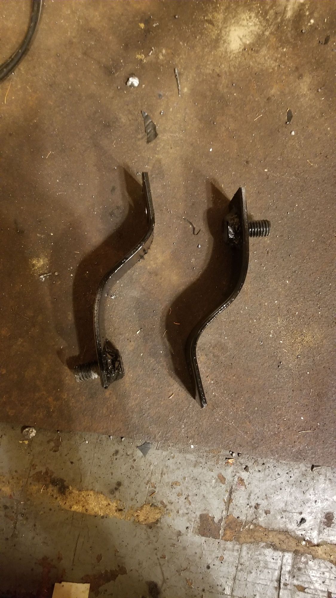

Also made these for the shift bracket on the transfer case. Makes up for the body lift and the trans being pushed back from original location. Just 1 1/2" flat kind of dead eyed the bend to give the difference in elevation I wanted. Checked fitment then drilled two holes in each. One end I dropped in a bolt then welded the head just to make it easier when bolting the shift bracket to it.
