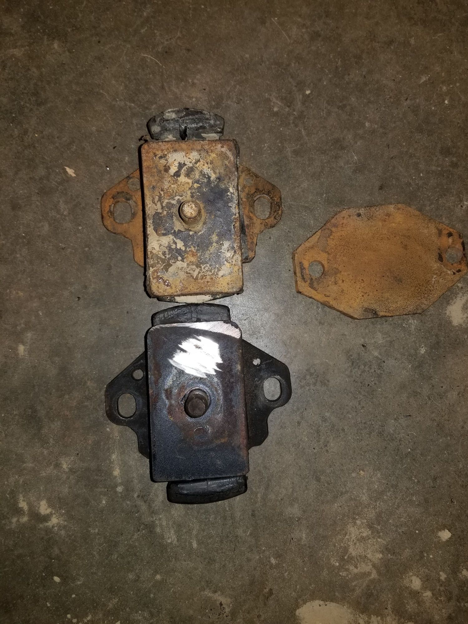

For the mounts off the frame you will need to place a 1/4 plate underneath the factory motor mounts. For the actually motor mounts there the same I used on mine. They are Jz to 22re mounts. For the 2nd gen v6 frames they need to be slightly extended length wise to bolt up.
