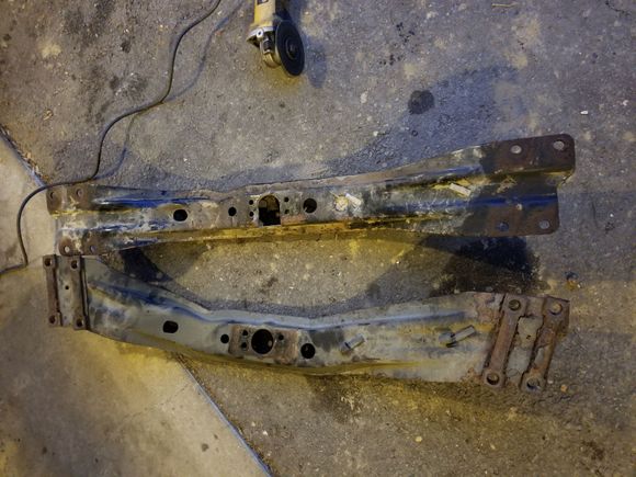

This is a wine by side comparison of the stock V6 cross meber and a 22re cross member. 22re is typically the one to use unless you build one from scratch which is what I did on my other 4runner. How ever if you notice I did half to notch out the front a little bit. Because the bell housing I used is a hair shorter it prevented the trans from aligning with all 4holes. Instead it caught the front two of the cross member only. Can weld a small plate later with 2 holes drilled later on. No big deal
