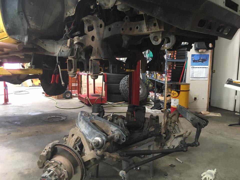

unbolted the upper control arms, idler arm, pitman arm, shocks, and torsion bars (we cut the passenger side torsion bar due to the hard brake lines and transfer case making it difficult to remove)
