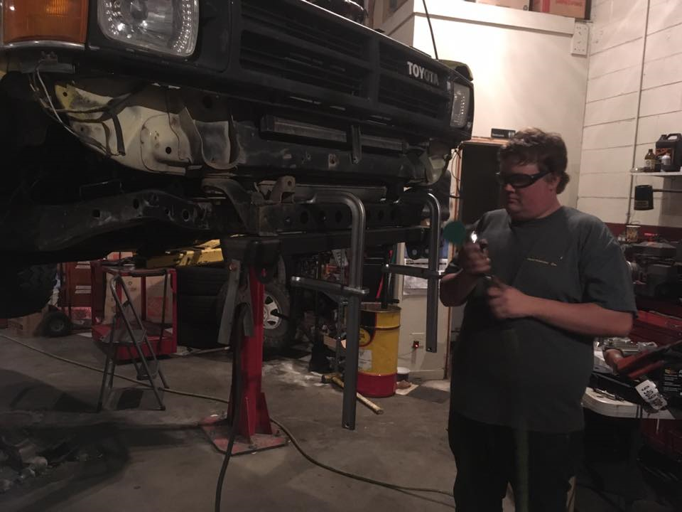

after everything is removed you have to tack on the front spring hanger, in the directions it says you can mount it either flush with the frame or 3/4" forward. I purchased the 4" lift springs with 1" lift shakles (total 5" lift) so i put it 3/4" forward so that we could get a proper shackle angle
