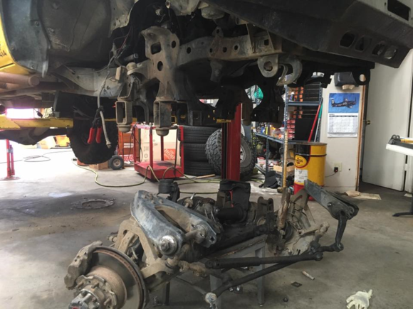

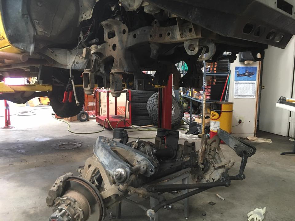

unbolt upper control arms, shocks, idler arm, pitman arm and torsion bars (the passenger side we cut the torsion bar because of the hard brake line routing and transfer case making it difficult to remove)
