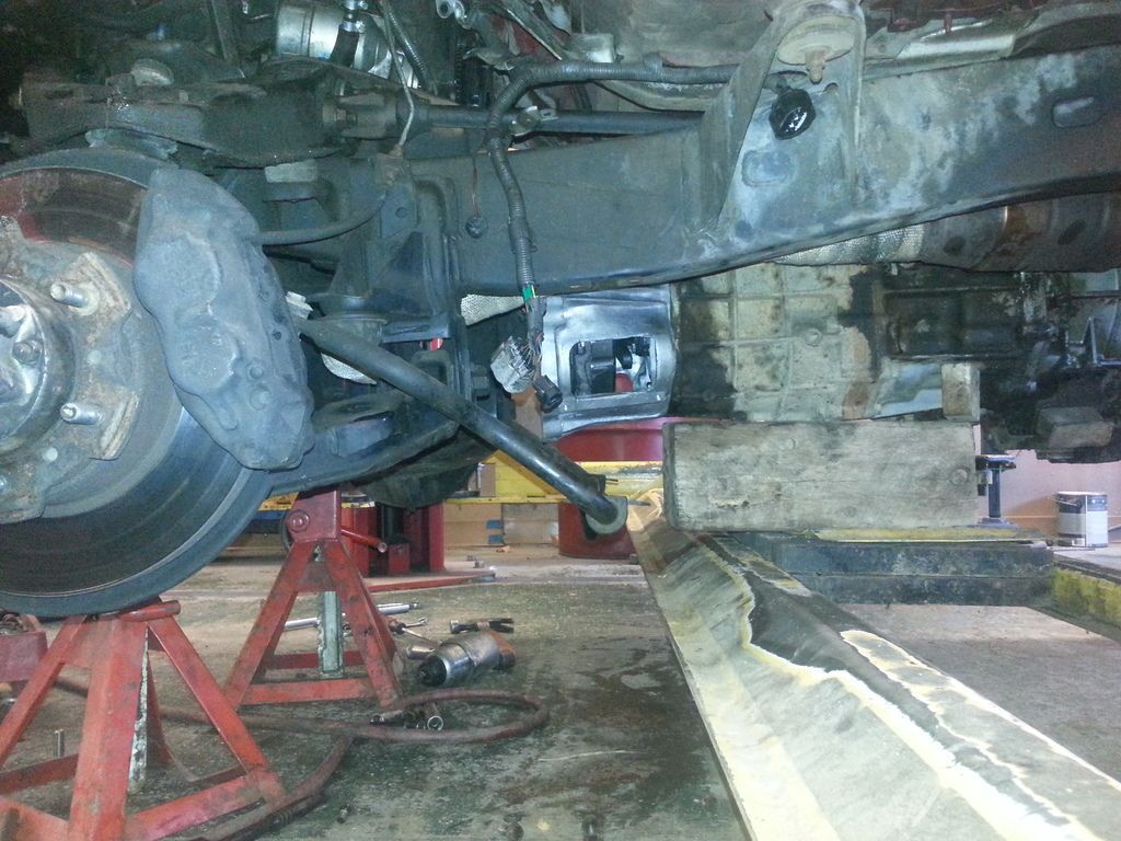

I had the rear raised higher than the front so woth the drivetrain tilt I could lower the old and lift the new transmission flat and not have to tilt it to line it up and the drivetrain was sitting level with the ass in the air.
