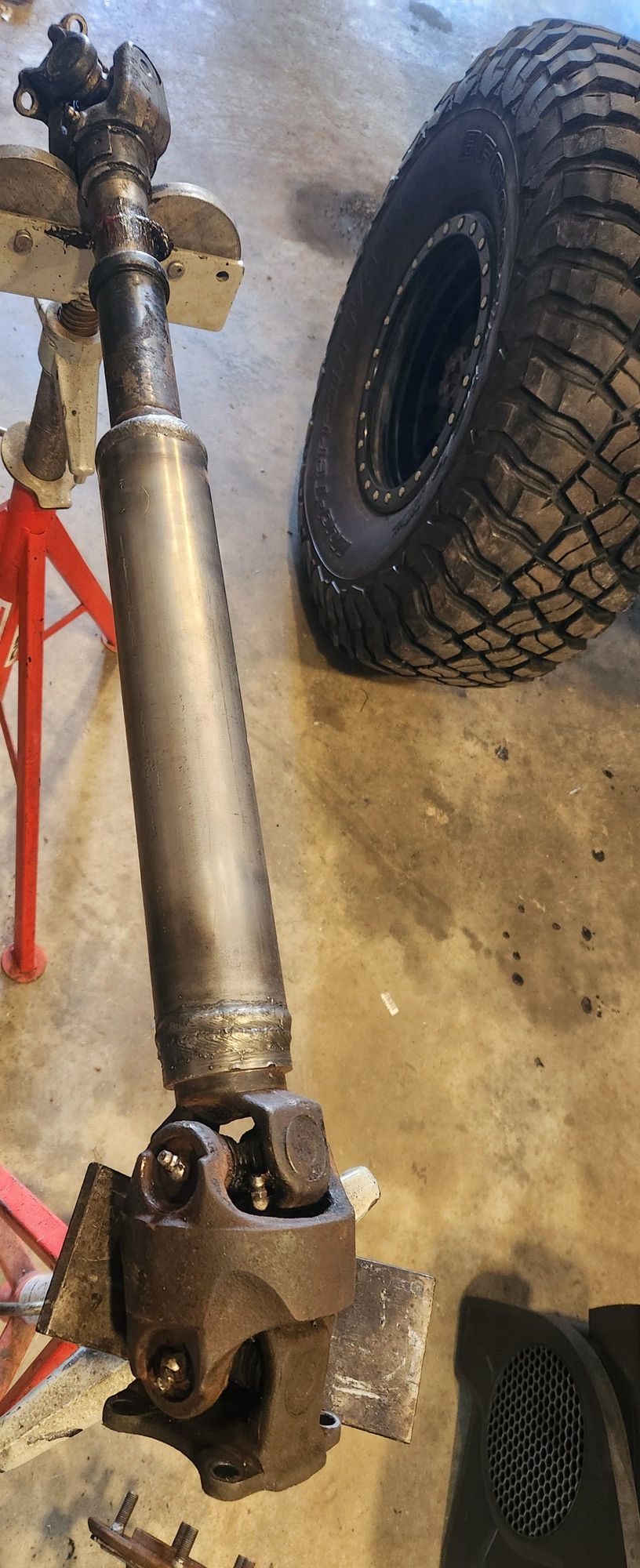

I dorpped the driveshaft off last week to have it extended. Couple days later they had it done and picked it up after work. I did not write down original length but i believe it was lengthened 3.5". This one i measured flange to flange and told them i wanted 33.375". I took just a little off the actual measurement to account for the minute amount of leaf spring settling.
