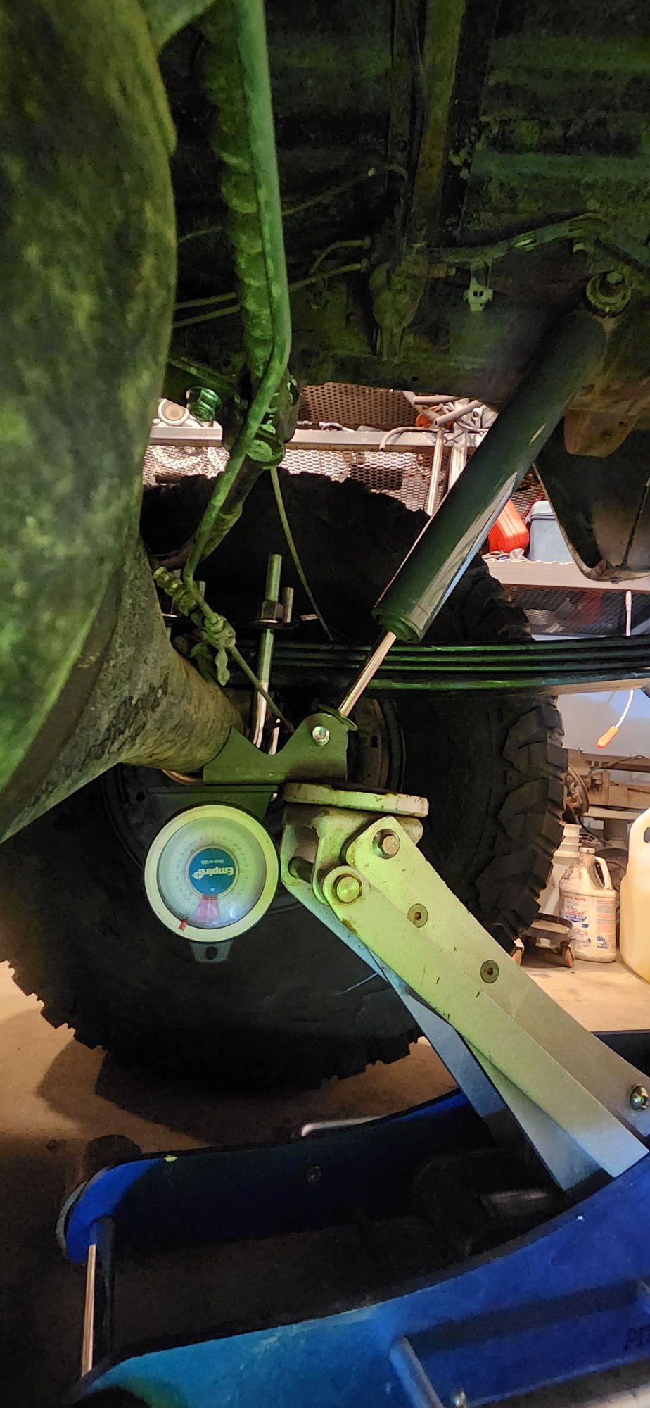

With 1.5inch blocks coming i didn't want to place this bracket perfectly straight. The block will jave a slight taper on them to help with opinion angle. So i went with 5° on ppacing the bracket. Did the same on other side but opposite of the same 5°. Hopefully when the blocks go in these will level out jist a little bit and look decent.
