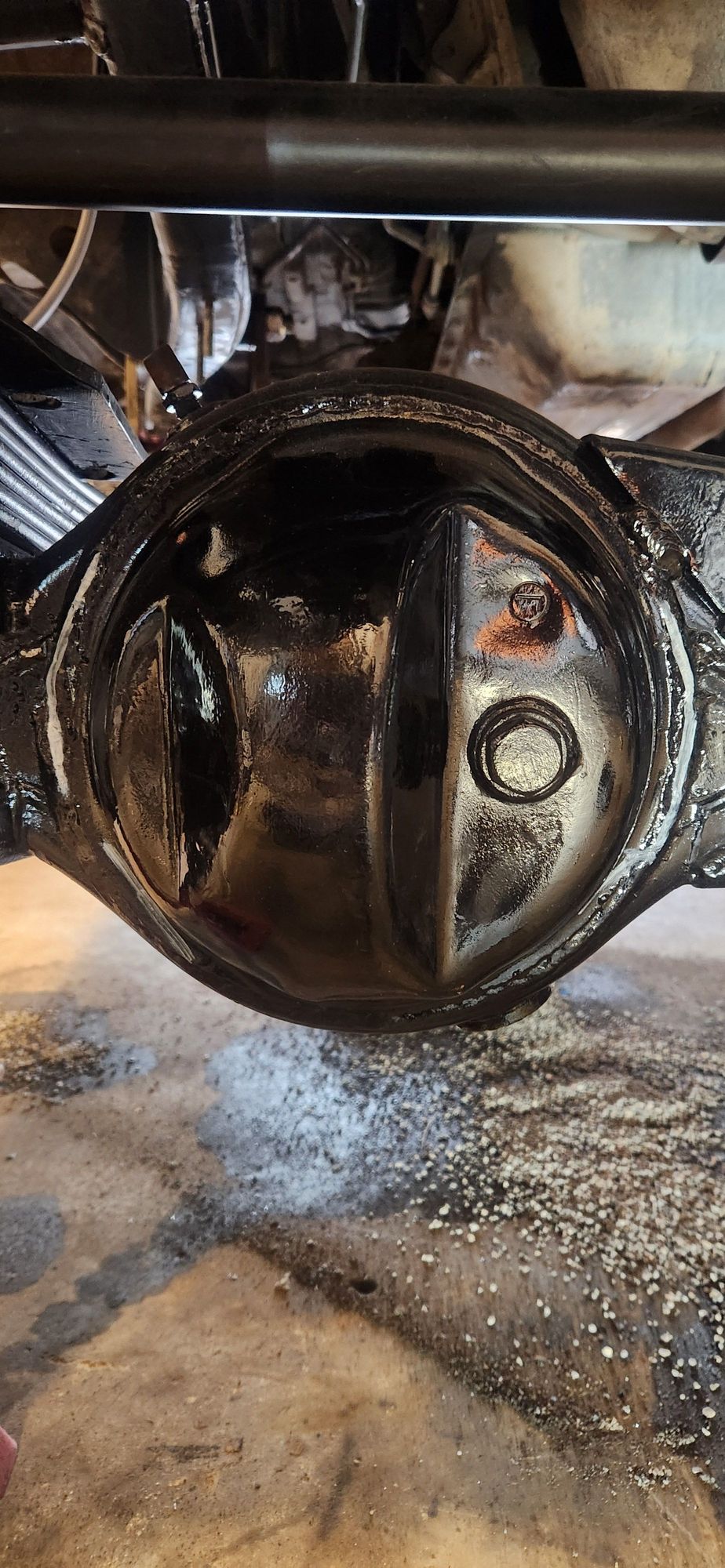

One U bolt needs to come out to be out the way for welding. Held cover up and roughly marked it. Wire wheel just where i needed to. Wanted to remove as little paint as possible from the axle.
