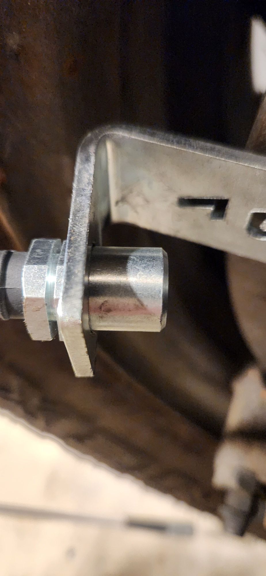

Im a big fan of low ramge backing plate eliminator with brake lone holder. It cleans the front axle up and gives it a nice look. However as you can see in the pic a fitment issue with the backing plate and the proved hoses that came with the sas kit. The hose is unable to step though the slot enough to catch the clip on either side to hold it in place. I have the same setup on my 1st gen runner for years now using All Pro hoses before they were bought by Trail gear.
