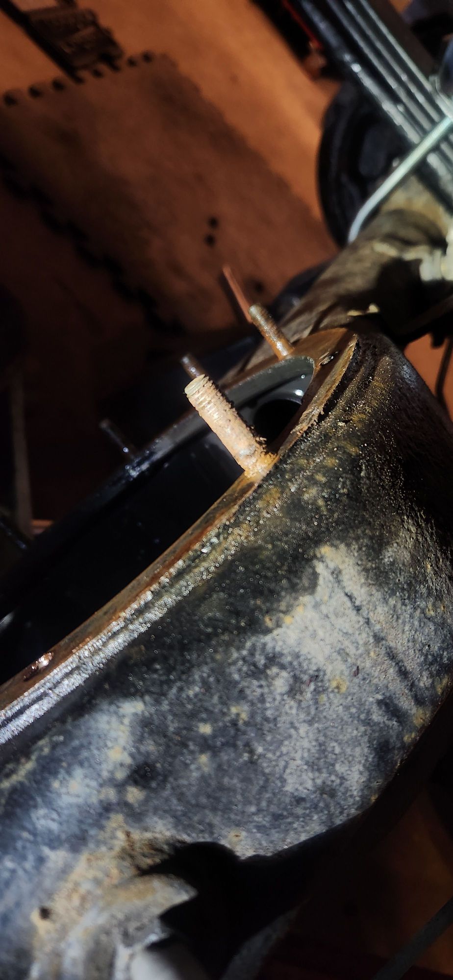

With a small gap on the bottomg i worked my way around with fitting wesges we use at work. I could see the stud flexing and moving with the diff so i was actually nervous i might snap it. With the two wedges and healthy amounts of wd40 i slowly worked them back and forth on each side trying to walk the diff off the stud. Finally after some patience and talking nice to it we finally became friends.
