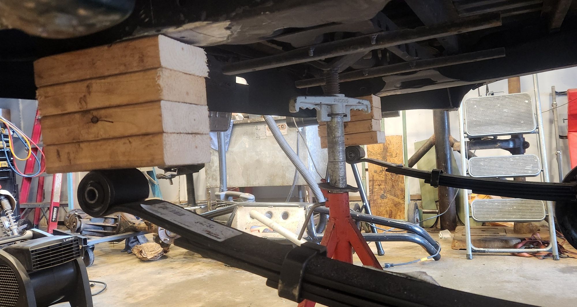

With floor jack under rear axle. Jacked the axle up and placed the wood between the spring and frame. Then jacked up just untill the weight of the truck was off the jack stands. This allowed the springs to take the weight and then hold the shackle up to it. Was able to get the bottom shackle bolt to just go i sode leaf spring. Then with angle finder i marked roughly where i wanted the mount.
