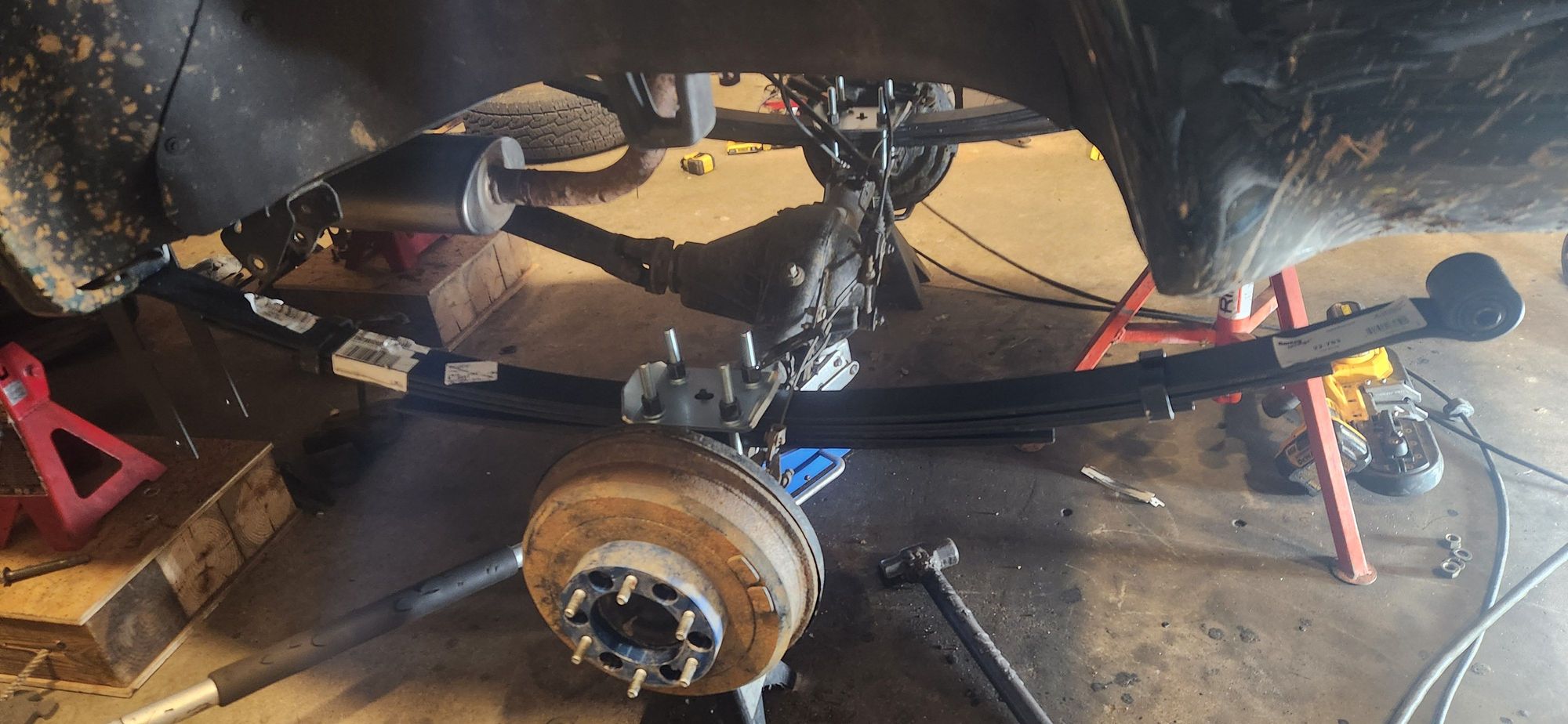

Satisfied with placement of spring in relation to axle. With the first spring tacked i could cut Ubolts on other side. Once those were cut then i could allow the pinion angle to match the first leaf spring and put ubolts on and bolt axle to it. Moved to other side and with the flat bars tacking the 2nd was painless.
