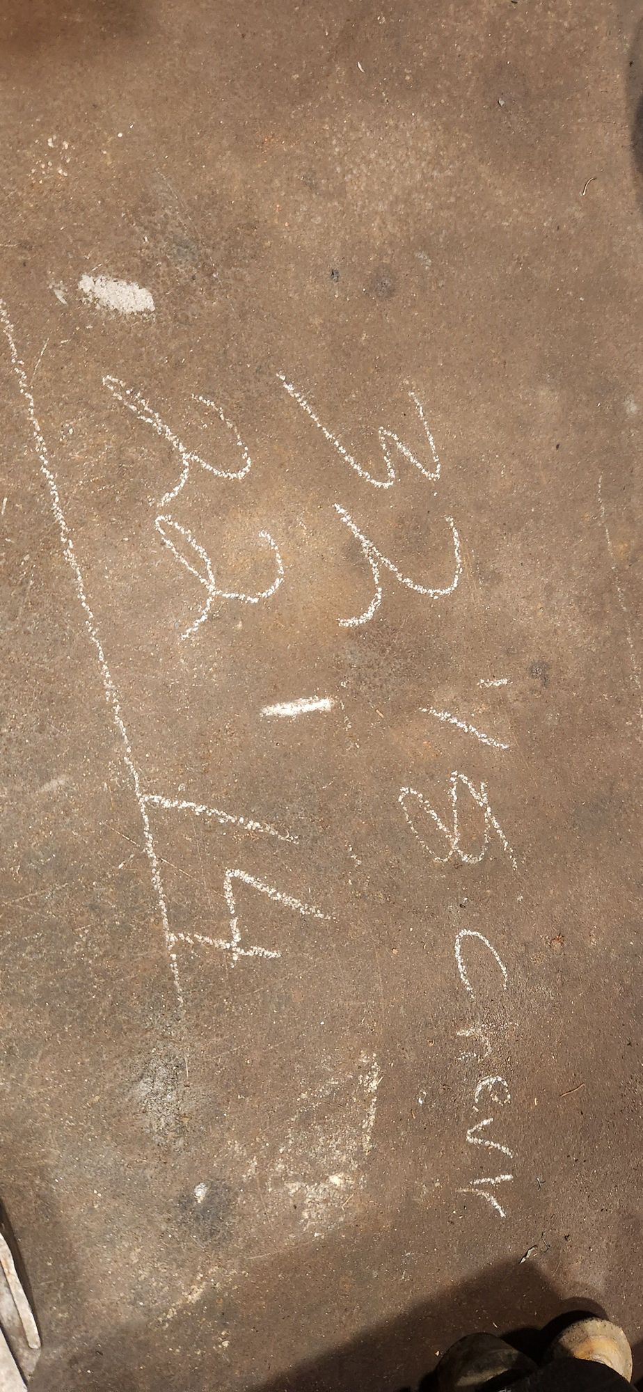

For your actual distance to move the front hanger. On the chevy leaf spring and the existing. Measure from front eye to the center bolt. Subtract those two, for this i had 9 7/8". They then added .25" to account for load on the springs. That brings me to 10.125" my hanger needs to move not 11".
