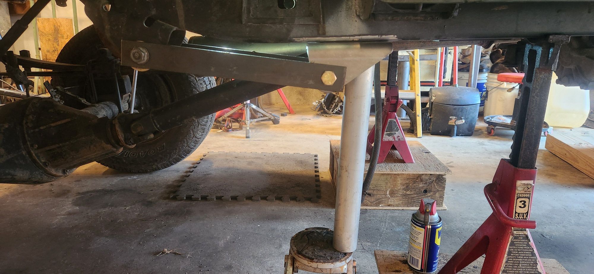

The stock mount is slightly narrower then the new chevy mount. Between the stock mount and flat bar i added thick fender washers to help accommodate the extra width. Tightened the bolts and then used jack to press against the frame. With it held in place i could easily check for square on the frame. This extra time made putting these much eaisier.
