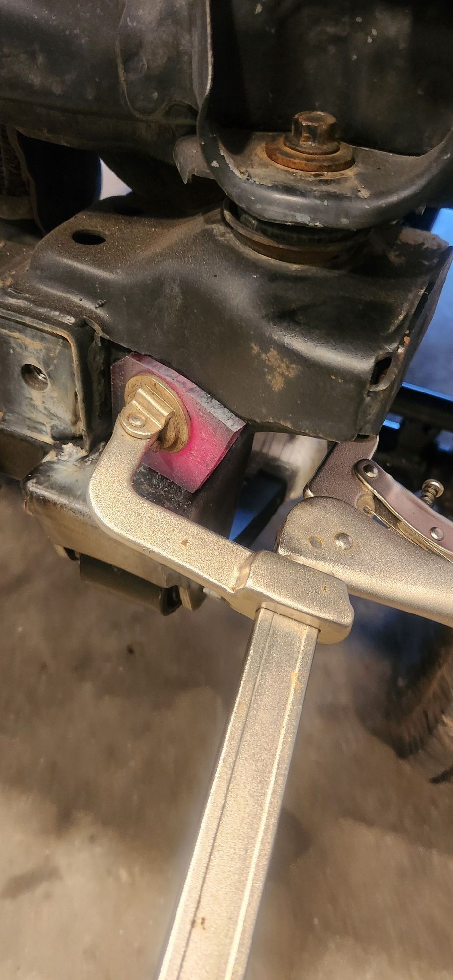

So instead i put it in the vise. Red hot with the torch and then set it in place. With the wide vise grips i then somewhat contoured into the body mount. This took about three times of heating it and crimping it. But i think it came out a little bit better.
