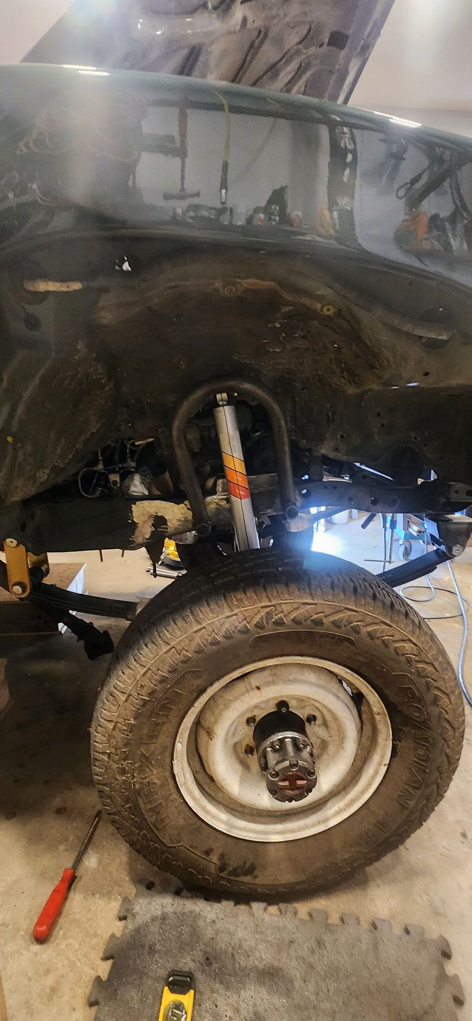

This is how the shock wants to sit using the factory bottom shock mounts on the front axle. Trail gear said to keep the shock bushings happy, not to push them too far one way or the other. But too keep the shock within the 12:00-1:00 ramge in terms of angle and It'll be good.
