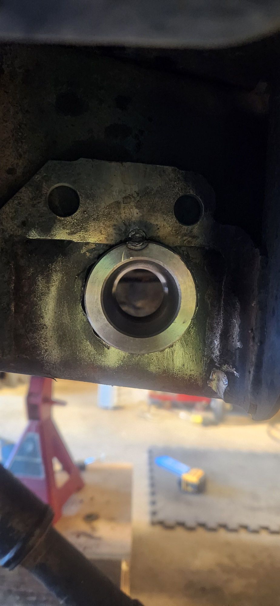

This part would of been much quicker with 2nd pair of hands. I spent probly 90mins setting the tubes and making sure they were square and center with the frame and front hanger as best i could. Going from side to side making sure i would be able to get both to match each other once tacked. I double checked them after each tack untill i had two tacks on both sides of the frame tube. End result, they are within a 1/32nd of an inch with each other. Took time but can say they are almost perfect.
