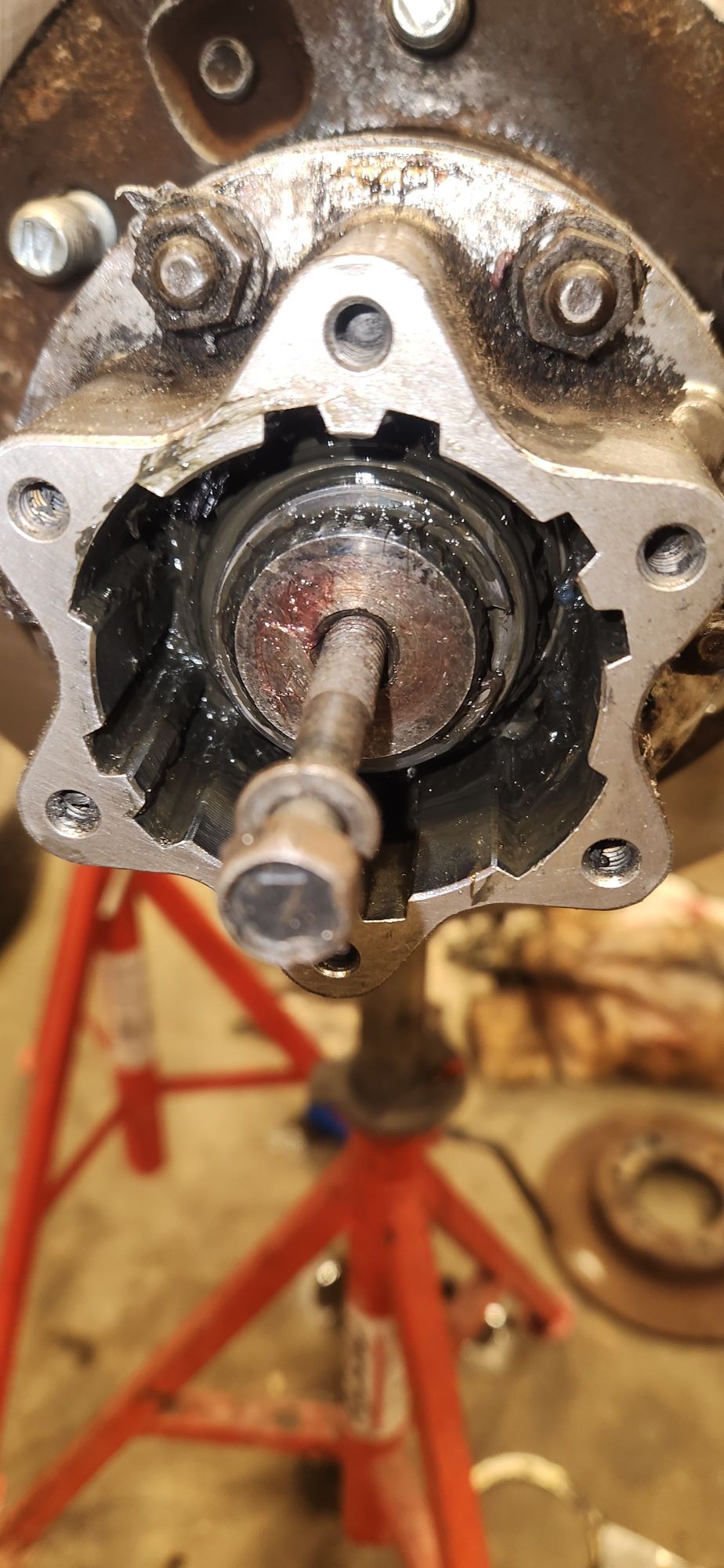

Using any toyota 12mm bolt you can thread it into the end ove axle. This give you something to grab and pull the axle through just enough to reinsert your split ring.
