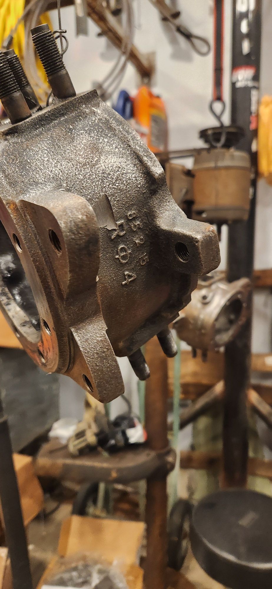

8784 runner January 13, 2026
Did not get as far as i wanted tonight. But hubs are cleaned up and ready for paint. The pressure wash was to get bulk of it, then the wire strips it down pretty good. Then in the garage i go over it and scrape any remaining with a screwdriver. A quick scuff down with wire brush and scoth pad. Then spray off with brake clean the wipe down with acetone. Hubs and maybe axle housing will get same treatment tomorrow.
