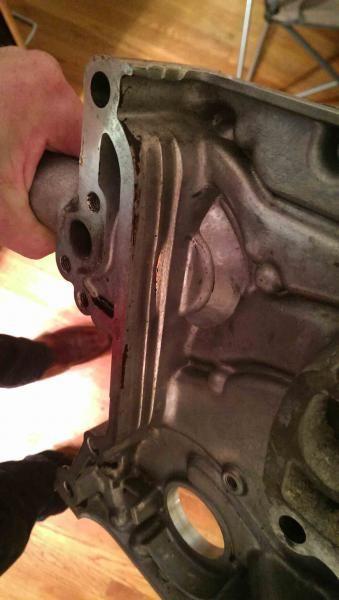

Worn through timing chain cover. The scary thing is that I didn't have a dual row chain....the two very different distinct wear lines are from the thrust bearings coming out and the crank had 1/4" of play front to back in it! That's what ultimately trashed the block.
