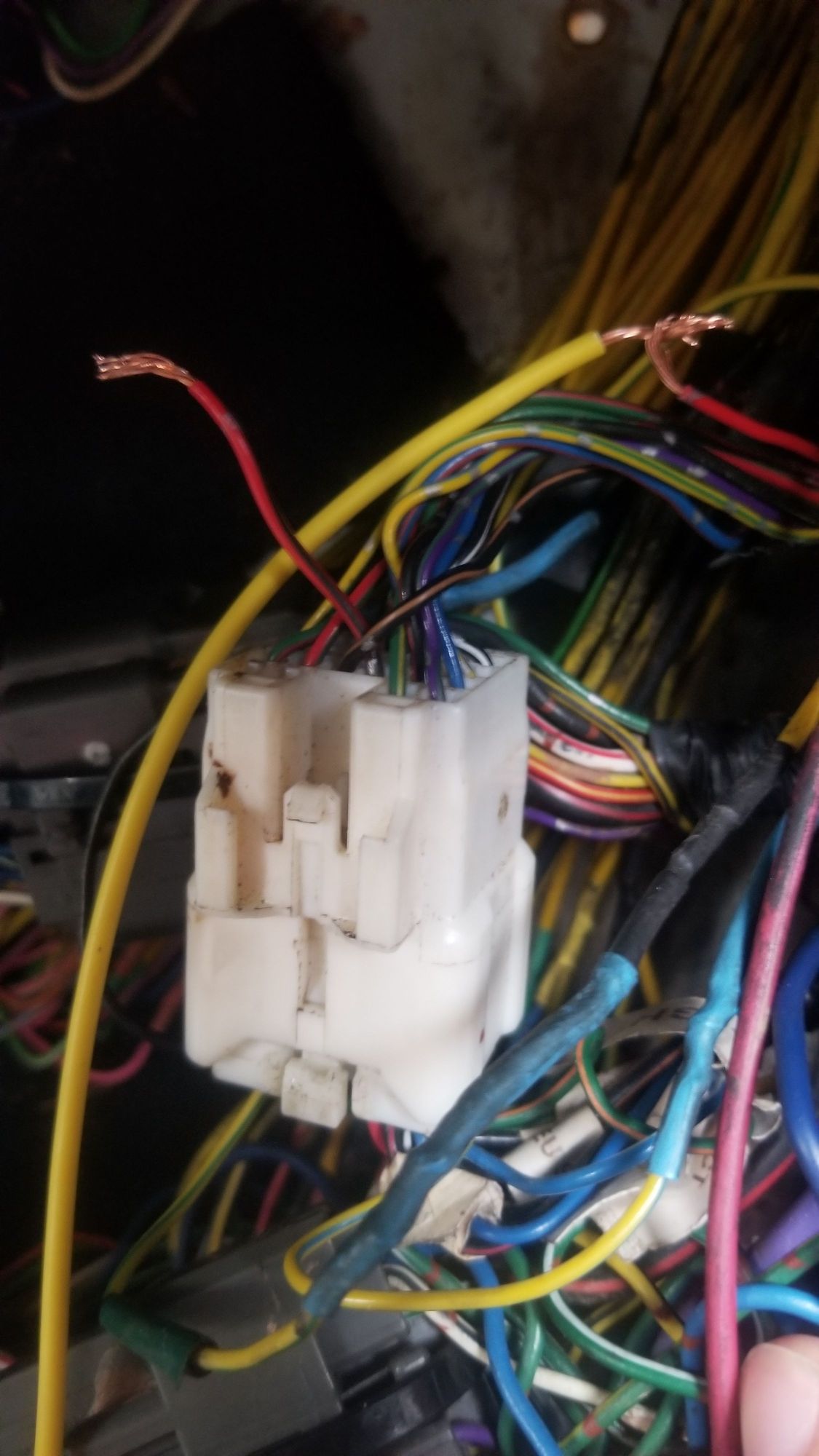

Which became red wire/black stripe at the body harness plug. I made a whip from the reverse light switch on side of trans and ran it to inside the cab. I did not get a picture of finished product. I definitely did not leave it like this, it was just while i was making sure i had correct wires before soldering and heat shrink. One wire from switch was connected here and the other i spliced into main batt feed for the auto ecu which is useless now with the 5 speed. Now we have reverse lights
