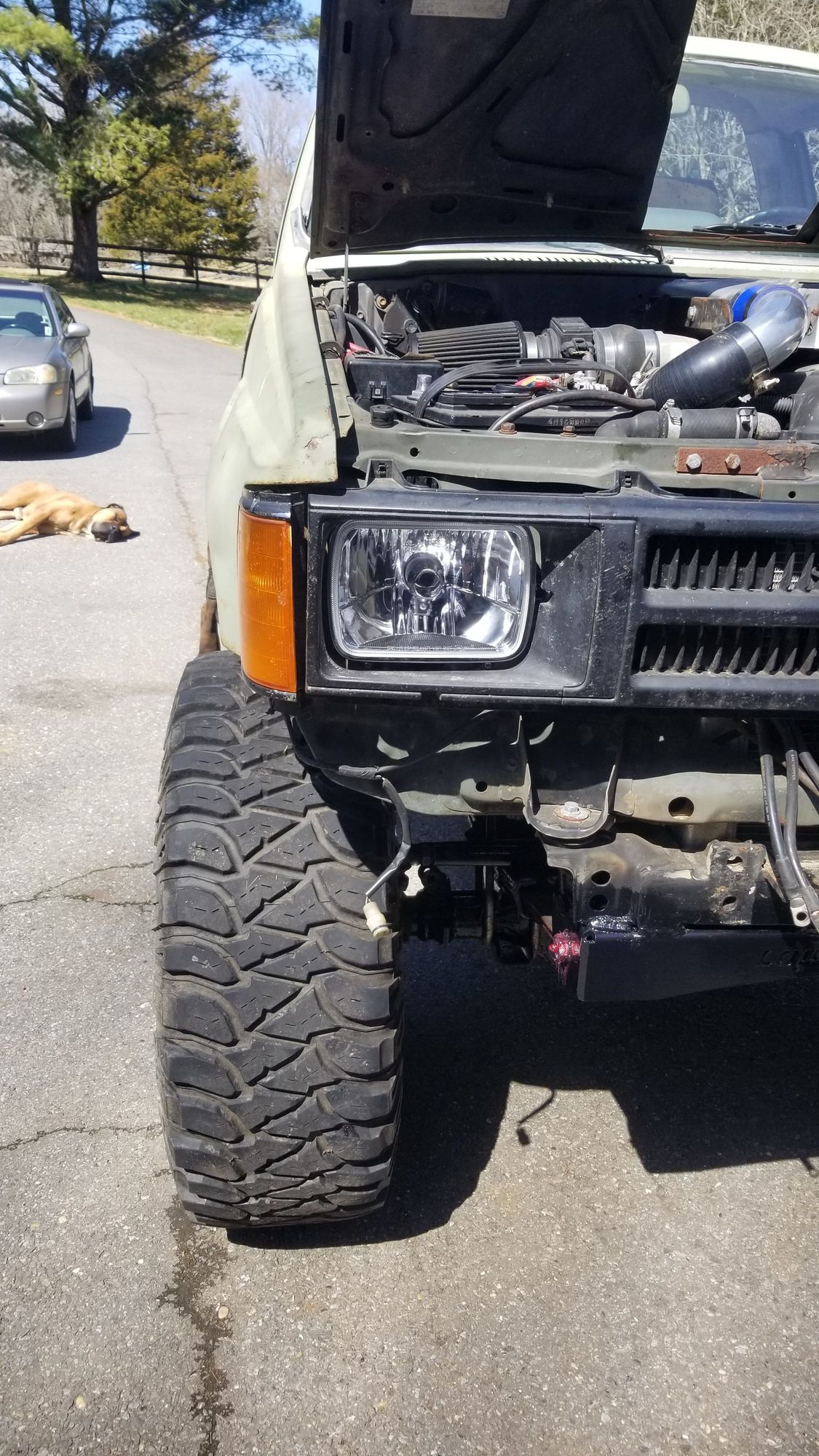

Checked the bracket on squareness and determined it is absolutely perfect front to back on either side. Checked the left to right squareness which is 1/8" out total which im fine with. Earlier when fitting i measured it was slightly out but decided i wasn't cutting all my tacs just to scoot it to the pass side 1/16". So then i looked at the body......The flare on the fenders is different, Passenger side is aftermarket, driver side Toyota.
