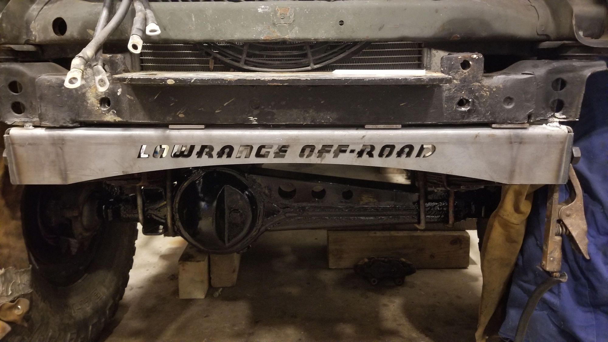

Cut the old trail gear front bracket off. This low profile hanger raises the mounting for the front of the leaf spring 1inch which will help bring bring my ride height down just a little. Welded the front sides completely and the tabs torwards the middle you see. Then did a 2pass the width of the frame on the backside of bracket as well. I didnt want to go overboard with welding to keep it a bit easier to cut off for whatever reason in longterm future. Once welded, cleaned up a 2 coats of paint
