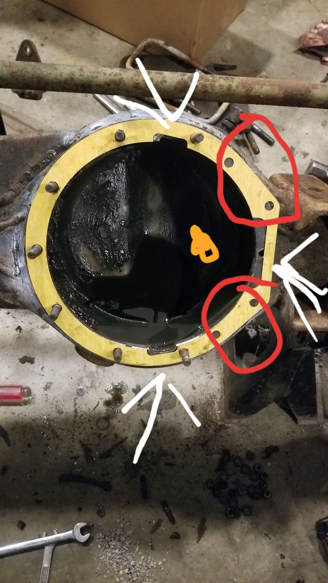

In white is where the housing needed clearence. In red is holes that need to be drilled and taped. The corner hole above the straight edge on right and below i needed to weld just a little bit to add metal then fade it to the mounting surface. They were very slightly off the original mounting surface. The threads are M8 x 1.25 pitch, 17/64 drill bit was used
