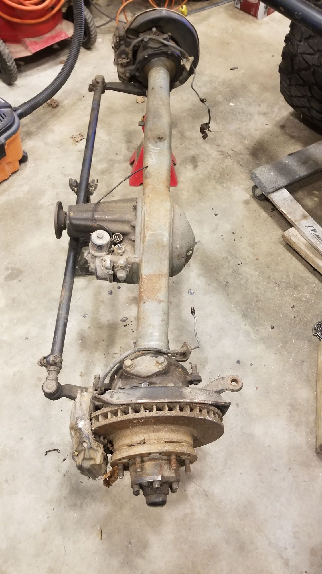

Decided to take care of axle swap in the rear with winter coming to a end. But first i will take care of the front. This is a complete fj80 factory elocker front axle. I will take this third member out and modify my stock 84 front axle housing to accept it I dont wanna use this complete axle strictly cause of the width. When i do the rear axle im thinking it will be closer to factory late 80's IFS width anyways. So the front and rear will still match by going this route
