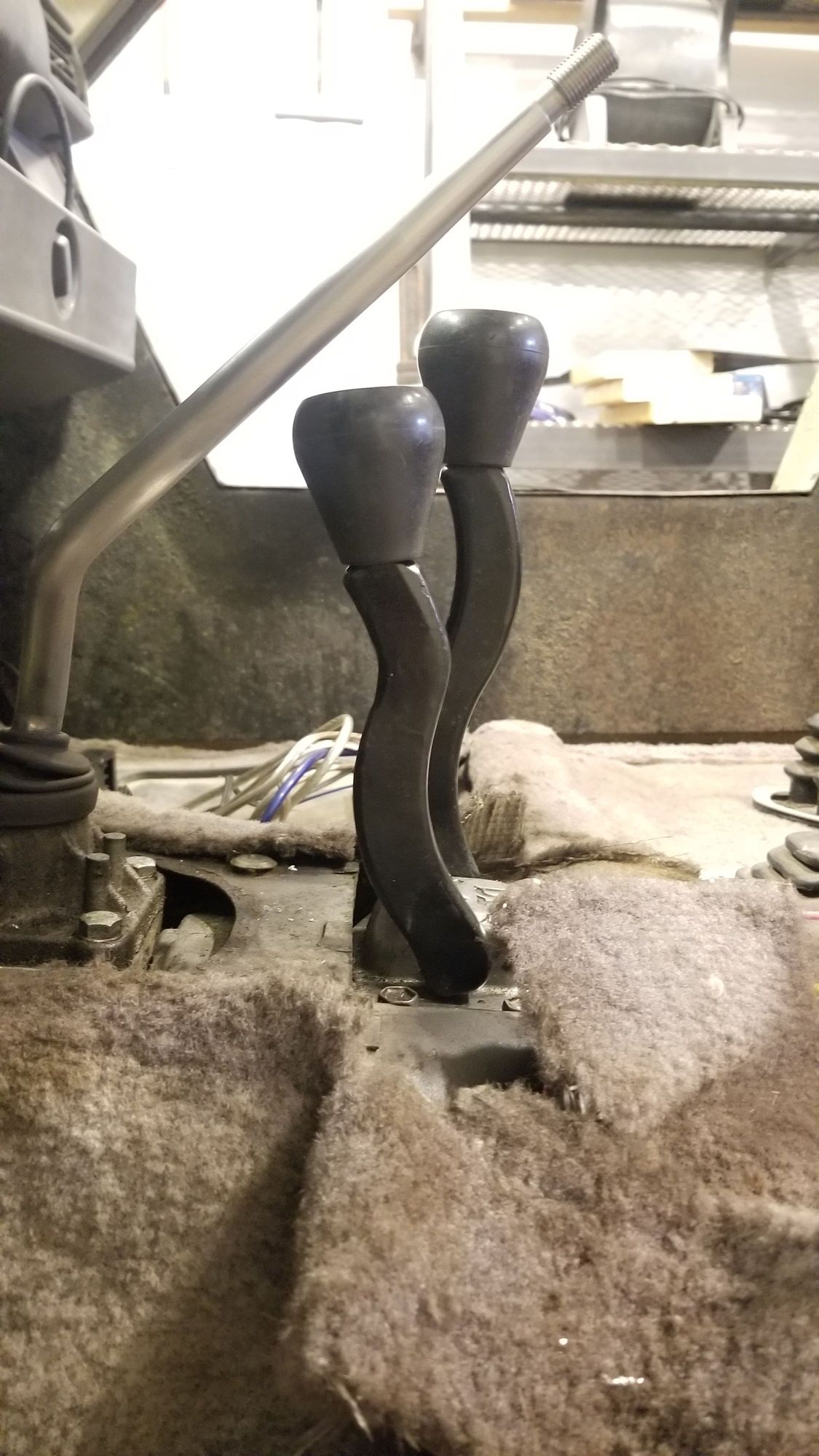

Something else i finally did after years of putting it off. The short shifter on my tacoma trans would always hit the twin sticks if they were in low and i tried to go in reverse. So i would have to pull the stick back to high go in reverse if needed then put it back in neutral so i could go back into Low. I took the sticks off the Tcase and put it in vise. Cut 1.250" out of it then welded it back grinded the weld down and featherd the bend back into it with a soft pack.
