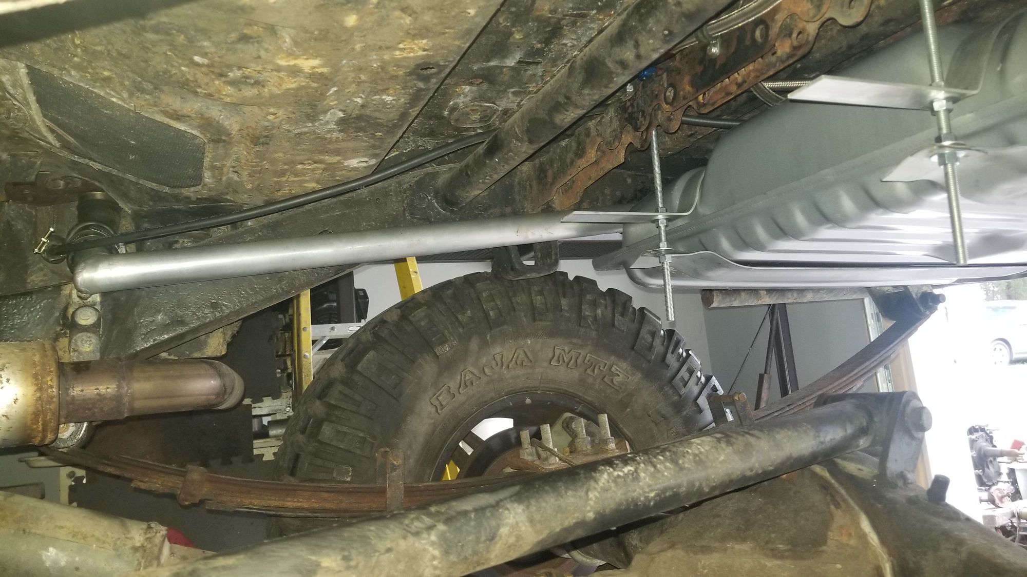

For now this is my fill, not really a fan of it on looks and the functionality aspect. It does have a slight grade too it which forces fuel to get trapped at the 90 bend and then the air forced out of the tank when filling must go through the 1/4" vent which takes forever and drastically restricts how fast im able to fill the tank. In the futur i plan on cutting a hole in the rear quater panel directly in line and above the fill on the tank and just using a filler neck and cap from a jeep
