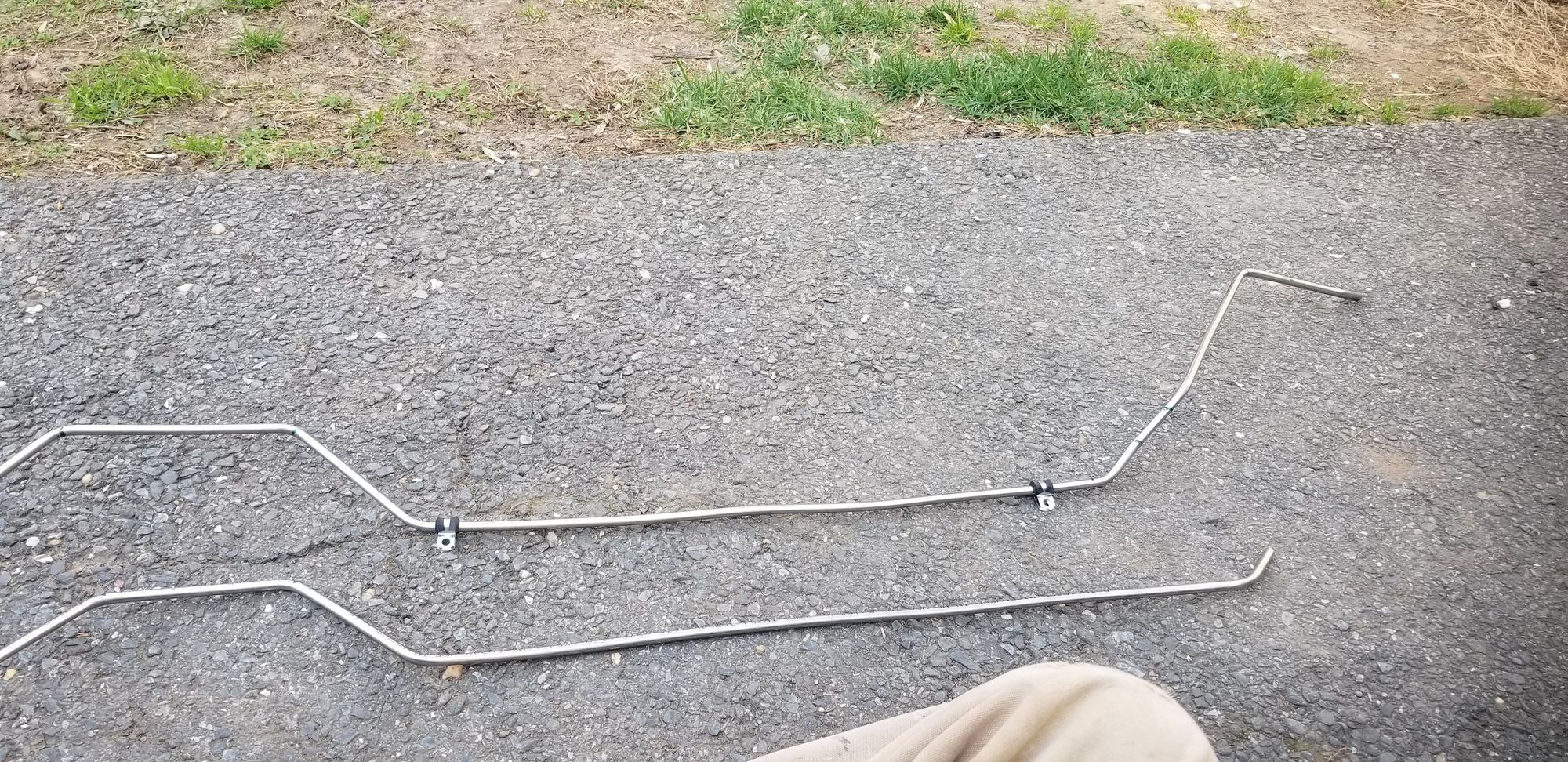

Pic of the stainless 5/16" lines i bent, i drilled and tapped threads into the frame. They come down from motor run along frame and jump over the trosion bar mount then high pressure rubber hose from the pump. I started with reg fuel line at first but figured out while heading home luckily that they dont handle fuel pump pressure very well.
