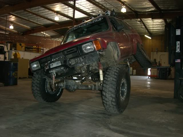

I don't have any pics of my Chevy swap or rears up front here at work, but here's a so-so shot of them at work.

RUF, Chevy 63s 35 km2s
