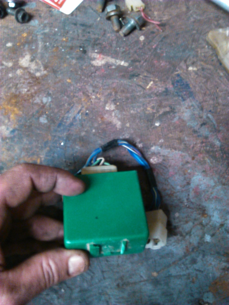

The only box I can see here behind the passenger side kick panel is the ECU, I'm assuming that no Int wipers does not mean ECU replacement? I was wary of removing the ECU to check for anything behind it. Is there a second location for this timer/relay for intermittent wipers?
I am more familiar with the 84-88 models the green box will be behind the ECU as shown in the picture and a little to the top. Just unbolt the two bolts on the floor board and the one bolt on the A-Pillar and let the ECU lay on the floor.
The green box slides onto a metal tab at the top. It is brittle plastic and I have had the plastic that mounts to the tab to break. I then have to use a zip tie to remount the green box in some cases.
