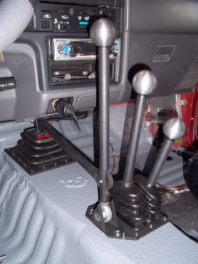

or you could do something like what this guy did:
http://www.pirate4x4.com/forum/gener...l#post12230923

Thanks guys. irab88 thanks for the pic. THAT....is pretty damn creative.
I have a complete 3.0 R150F but then I'd have to get an adapter to run my dual gear drive cases. I'll make the 151 work. Mines not as far forward as that guys.

I had to dog-leg my shifter quite a bit; the old shift boots (the rubber and the pleather ones) will both kind of fight you, as the resting positions are now different. I have since just made an inverted boot pattern & it all works well (7 years of daily driving no problem). Please note the significant cut going forward; you'll need to trim almost all the way to the pinch weld to have room for shifter movement. I wound up making a whole new base plate for mine.

Thanks for the pic 89934rnr. Pretty much what I'll have to do. I put a block off plate on the forward shift hole because my dog legged shifter will be almost on top of it. I have Davez triple shifter on the way for the cases. I also have a MC short shifter for the trans.
