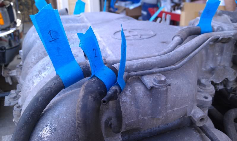

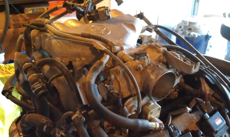

Hi all,
Working to wrap up my swap and I'd like to use this thread to locate my last questions instead of creating individual threads.
I bit of background... I've installed a 2001 4Runner 3.4 with an auto transmission into my 93 4Runner with a manual transmission. I was planning on repinning the auto harness but ended up getting help from a Denver guy (Cliff Cozier) on the wiring and we sourced a MT harness. I've also gone with a pre 01 evap system and throttle body. The engine is in the truck and I've done all the prework (moving battery, evap mounting, fuel line flip, etc.). I'm waiting on the older throttle body to arrive and then I'll be one to buttoning up and hopefully turning the key soon.
So my first question. The 93 alternator harness had a very small ground coming out of it. What do you guys normally do with this? Upgrade and location of the mounting (ie. body only)?
The second question is on the two hose ports on the rear of the engine shown in the pics below. The first pic shows a black hose port kind of between the fuel rail and lower intake. The second pic is right behind the lower intake. Apparently I failed to take good enough pics during the removal stage.
Thanks guys!

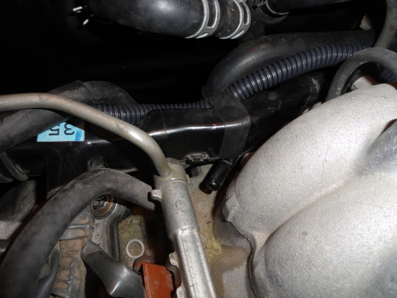

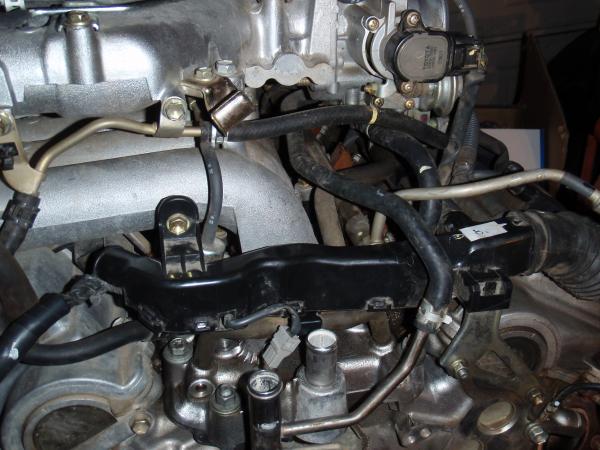

Not the best/clearest pictures, but these were from my disassembly, but the port in your second picture should go to the middle tube bolted to the top of the intake (labeled "2" in my picture). Keep in mind that this was for a 96/97 4Runner so it may be a little different than yours.

And I'm not really sure what the port in the first picture is for, I can't find a similar picture of mine.

Thanks for the pic! My upper intake is a bit different. Where does the other end of your #2 line go? Into the airbox?
I think the black port in my first picture goes to a hose that connects to the throttle body. See attached pic. Hopefully that makes sense with your setup as well.

That U shaped hose right in the foreground in the other end of it and it plugs into the intake between the MAF and the throttle body.
That black port probably is for a coolant line to the IACV (Idle Air Control Valve) on the throttle body.
So does the #2 line in your picture connect to a different size hose port on each end? My upper intake does not have the hard line in your pic and the hose port on the engine is larger than the one under the throttle body.
Also, what I'm assuming is #3 in your first pic (smaller tube and hardline on the upper intake) is that elbow you used closed off on the open end?
Thanks!

So the small #3 vacuum hose is just a true vacuum hose, from the intake manifold to a T fitting with one end going to the throttle body, and the other end of the T fitting (un-connected in that picture) goes to the vacuum tank in the passenger fenderwell for the ADD system.
As for the #2 hard line on top of the manifold, it looks like it should use the same size hose on both ends. I'm not sure how your's needs to be routed, but for mine its a vent of sorts from the driver side head to the intake (before the throttle body) to burn off any gas/oil vapors from the crank case.

This might be helpful, its the parts diagram from Toyota Parts East for a 2001 4Runner, click on the "More Info" button to get a diagram of the hose that I'm thinking of. Its labeled "12262" but if you don't have the hard line on your intake, I'm not sure what to do.
http://www.toyomotorparts.com/compon...-01-11836.html
I would look through there (it can be a pain) looking at the various diagrams to see the exploded view of everything.

So I'm thinking that if I'm no longer going to use the ADD system on the 93 then I don't need to the T and can just go straight from the hardline into the intake, then cap the ADD vacuum ports?
