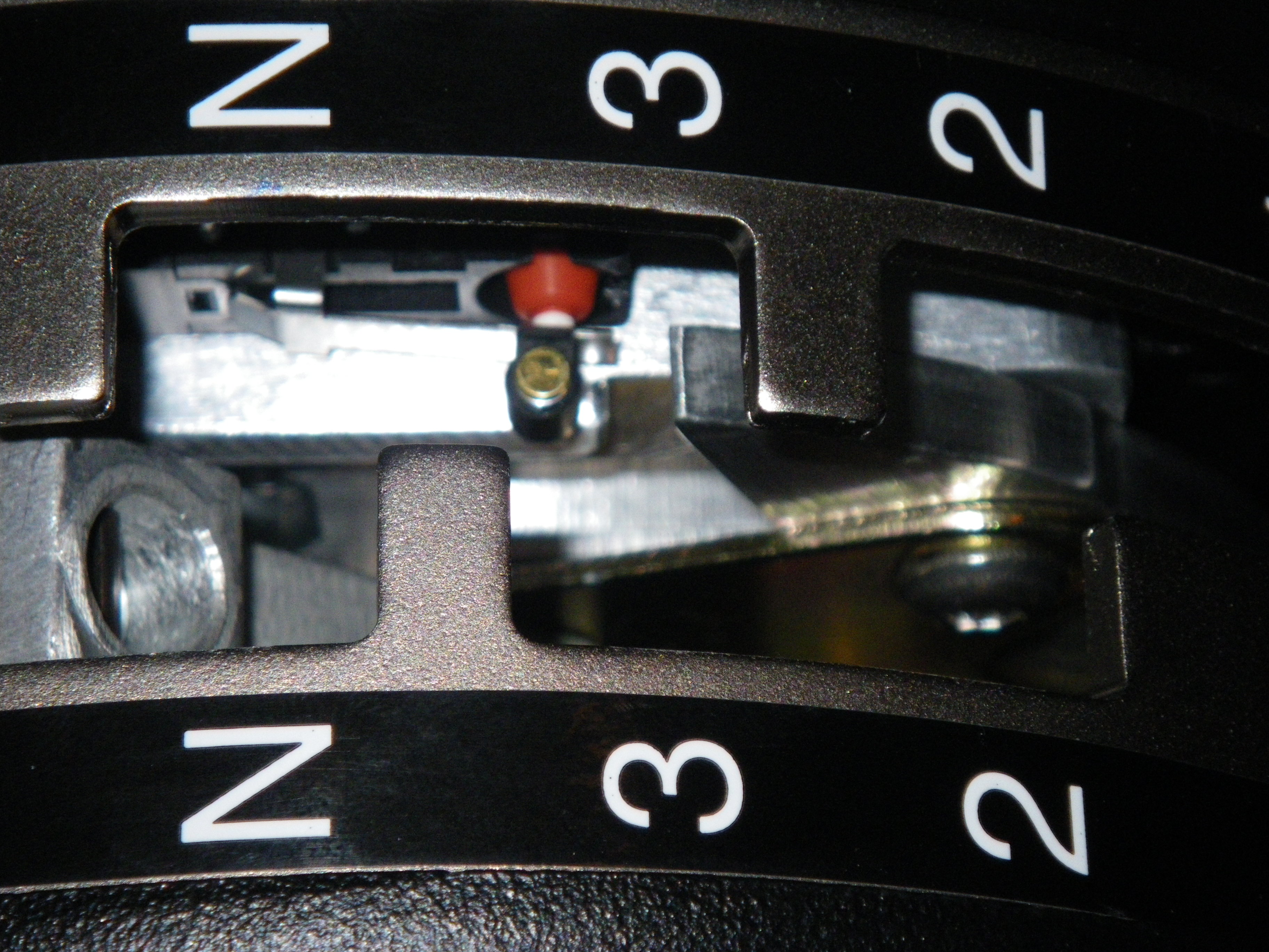

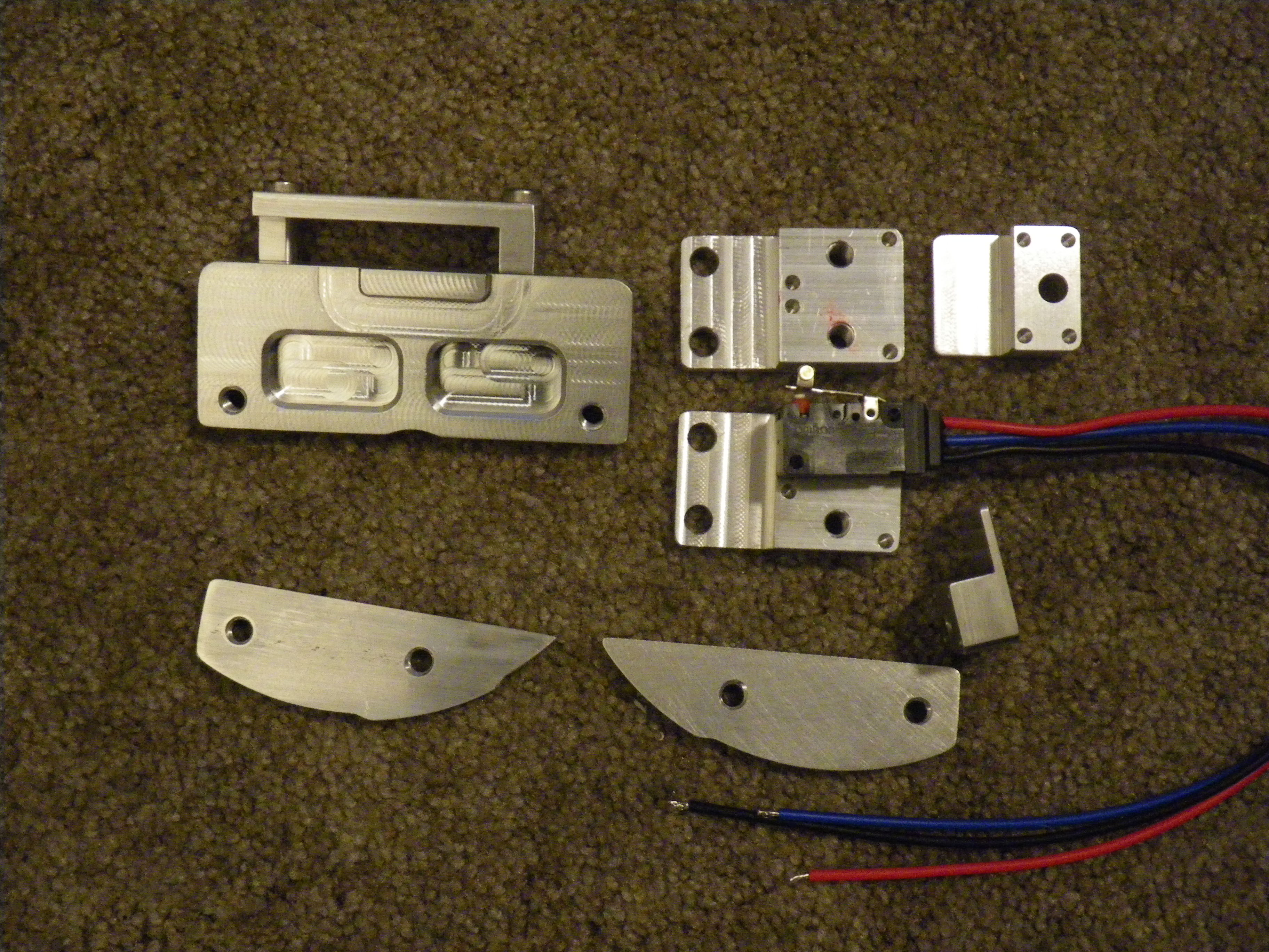

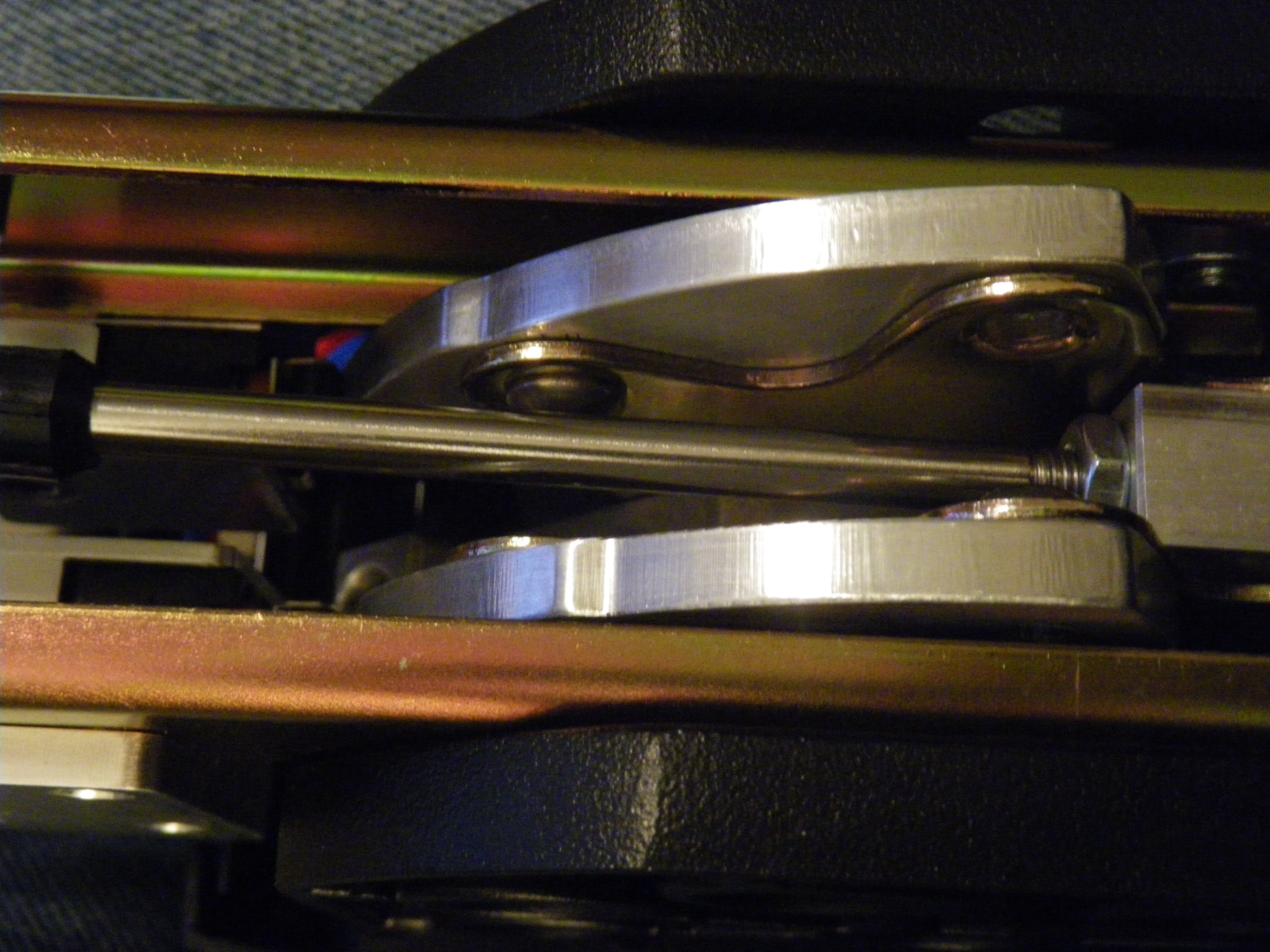

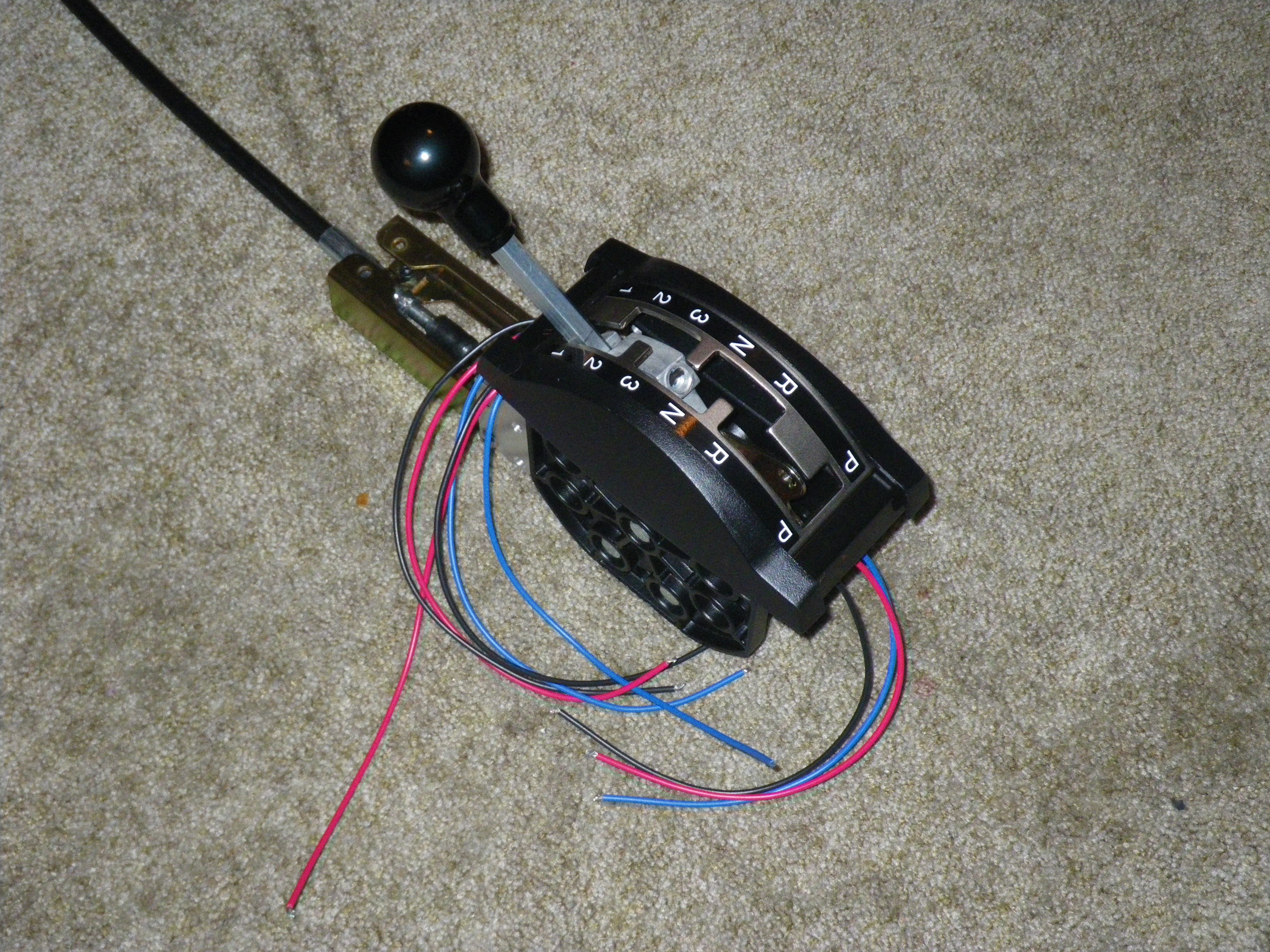

So Winters is now selling AW340 shifters. I saw that these were going to be available right after the PRI Show I was at, so I had to buy one. I always like the Winters design.
So I made a Electronic Shift Control kit for my Winters shifter. No holes to drill, just bolt on a few brackets and a couple cams on, and wire in the 3 switches and go wheel.
It's designed to give me 1-4 shift control electrically while using the mechanical shifter, this will help with downshifting and compression braking. Not what I need for snow wheelin' but here in the Midwest I think it will work fine.
Still have to get out and test it but at least all the parts are done.
Parts-I actually use 3 of those switches.
