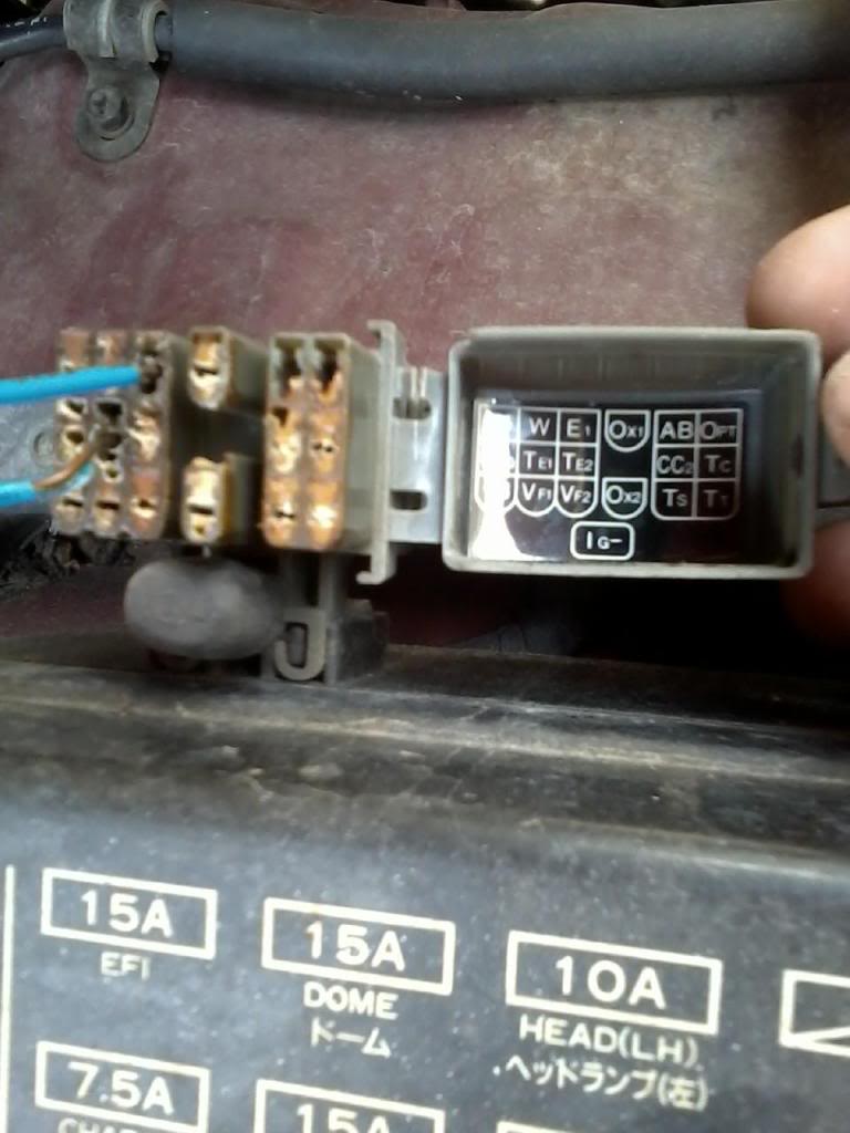

My 86 has the sensor in the exhaust manifold so am fairly sure yours should be there as well. Below is the port for your diag test. I used a wire but you should use a paper clip instead. Are you sure it is getting a good connection? Is bulb in and good on guage?
Posting both Jumper diags for some others that migh look up codes but yours is on the bottom.
Codes... http://4crawler.com/4x4/CheapTricks/...es/index.shtml
How to get Check Engine Codes. I just put this up for others. Applies to 87 and up. 86 and older is the bottom picture.
The Diagnostic port for the 85-86 is on the Drivers side inner fender and is nothing the same as the 87 and up. Here is T1 and E1 jumped. The codes and engine flashes are the same as the rest of the trucks on the dash.
Codes...http://4crawler.com/4x4/CheapTricks/...es/index.shtml
http://www.youtube.com/watch?v=9qEQM...ature=youtu.be

I was pretty sure of where the O2 sensor should have been. Hell I looked from head to muffler and there is no O2 sensor. The previous owner put a header on it and there is no bung or sensor anywhere. As for the test port. I jumped it just like in the bottom picture and the check engine light just stays solid...never blinks. Im going to get a multimeter tomorrow and do some more trouble shooting.
