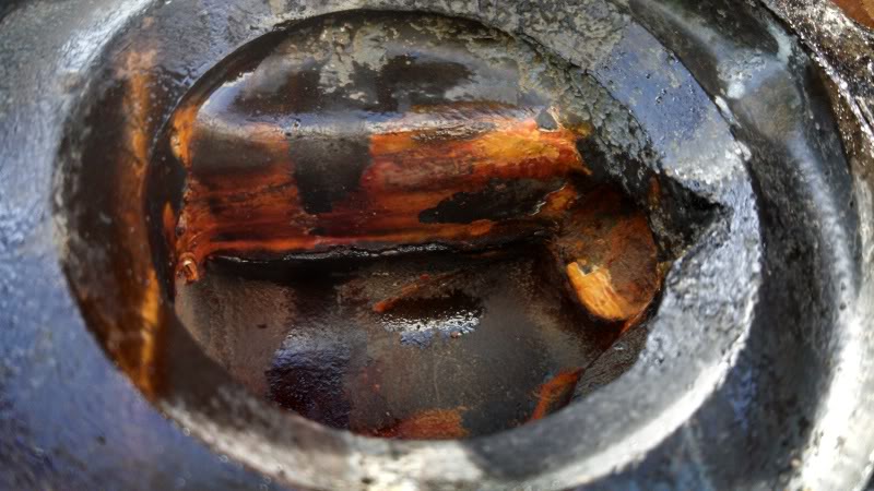

A crack where the water pump sits

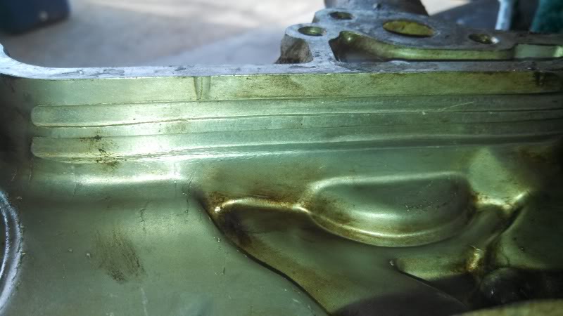

Timing chain groves. The wierd thing is that the guides were not broken. So im guessing the chain is jumping or the was a previous issue from the old owner and he replaced the guides and chain but keep the same cover. I can not tell if the crack goes all the way threw to the groves but it looks like a pretty narly crack so im almost position this is the problem. I did not pressure check the head before pulling it which i really regret but i would really like your guys insight on if you think this is my problem? I already ordered a timing chain kit with cover but my dreams will be crushed if this is not the problem. Please give me your thoughts
The grooves appear to be old due to they are the same color as the surrounding cover. I presume it's been thoroughly cleaned. And the crack does look to have some seepage from something. I would guess its cracked all the way. But don't rule out that head gasket... Are you running head studs? If it were mine, and I was prerunning it, pushing it constantly, I would at least stud the head and high quality head gasket. Then again, I wouldn't be to keen on prerunning a 22RE(turbo included).

Yes that crack looks like it intersects the chain wear, just a spec/pixel at the bottom, it's not the best angle. There are two more cracks or other odditys below that also, and one of the lines up with the upper crack that is showing discoloration from something (likely flowing thru it).
You can pick up a penetrating dye test kit for these kinds of inspections.
