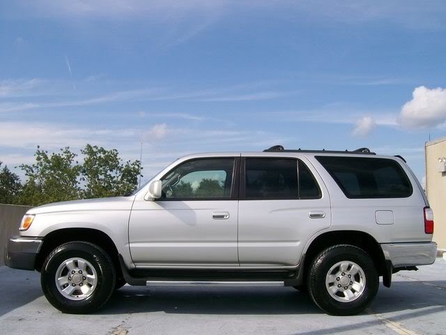

I have an 02' lowrider that i'm ready to lift and put on some 32s, but im not liking the amount of tire gap that I see on the full 3" lift. Especially in my case since my truck lacks fender flares. I was looking into either 99 coils or the OME 881/906 setup with comfort shocks. I've read mixed opinions on both, but I thought I'd query some other owners to get a take on their setups. I also have a brush guard but I don't think that will put any stress on the light duty OME coils in front.

Check out bizzyboi's post after the 2" 881/906 install. The 32s (equivalent to your 265/75/16s) don't seem to look terribly small. Looks much better than stock. Why do the 3" with 33's when you can save power and gas with 2" and 32s?
