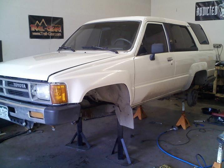

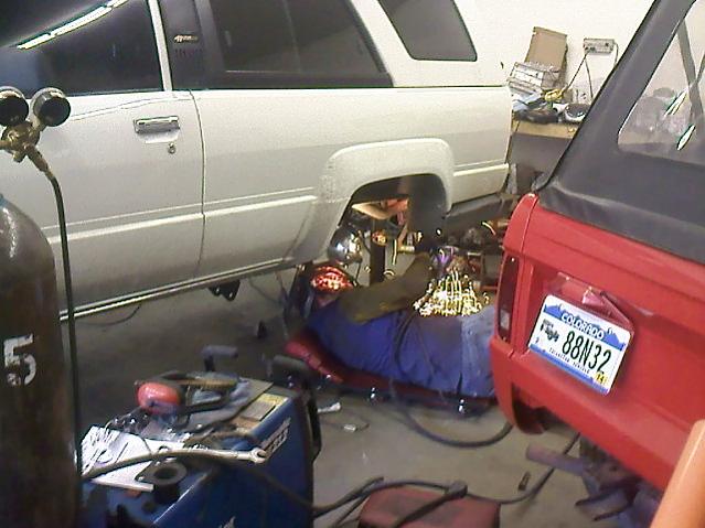

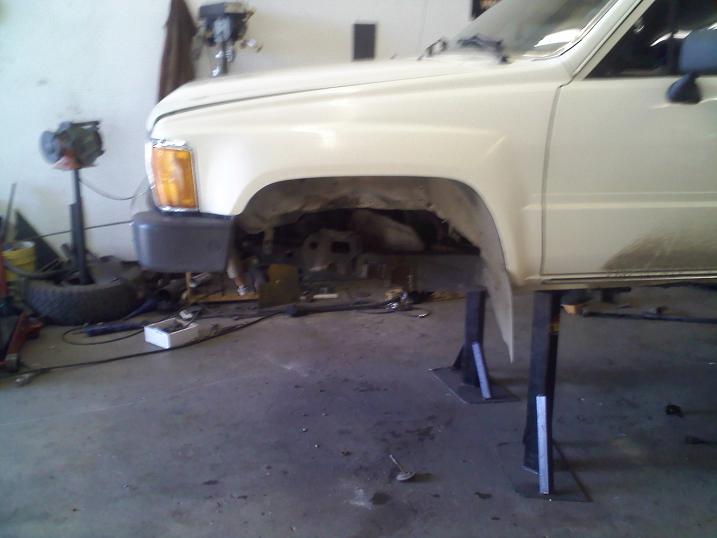

Started this morning. Nothing had been done on this except that it was on jack stands ready.
This is an ultra clean 89' 4runner. 22RE 5spd. Zero rust on it and like two penny size dings in the whole rig. One of the cleanest 1st gen 4runners I have ever seen.
These pics were taken at 9:45am this morning. I will update today as we get closer on this.

cool though like the bigger pics you usually have for your builds
how big of base plate on you front jackstands?
I want to say 24"x12" at least. They aren't going anywhere. I have done numerous swaps with those. I am saving for a lift at this point though.
